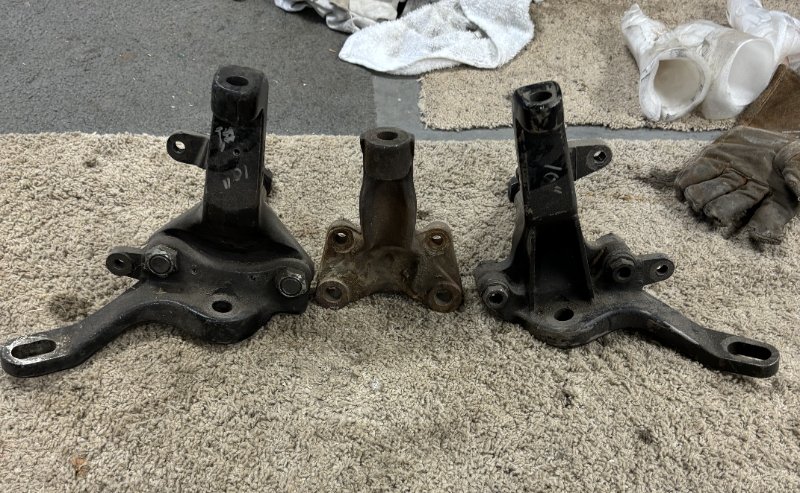

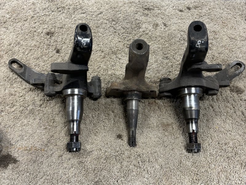

If you want to really start playing around with geometry and changes spindle heights have on roll centers, get some dedicated race spindles.
These are from a road race (thus symmetrical) ARCA car set against a stock Mopar spindle. Since many of these oval track units utilize the Mopar style ball joint, these are a good match for our ball joints. These spindles do utilize the same lower ball joint as the upper and have integrated steering arms, so you would need to use late B lower control arms. They also are from the era of 15" wheels, so they only utilize a 12.12" rotor. Adapting a larger 13" unit would require modification of the caliper mounting brackets, but that is no big deal for a good welder/machinist.
I'd like to see an F body spindle in there too for comparison
I'd love to, but I'm all outta F spindles. If anyone would like to sell me a pair cheap, I'd be happy to include them in the layout. They are only .375 taller than the stock spindle pictured, so they wouldn't be significantly different, but it would look different as the stock spindle I have in that photo is a drum brake unit
