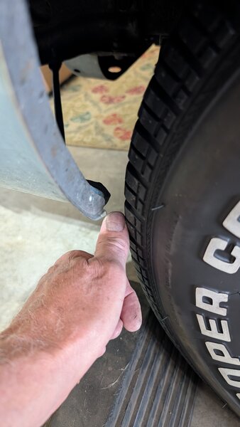

I run 215/70-14 with no clearance issues.
The 15" will be 1/2 " bigger all the way around.
And I'm real close to that on the front end of the front fender opening at a point in a turn at ride height. A little closer at compression.
Thumb for reference

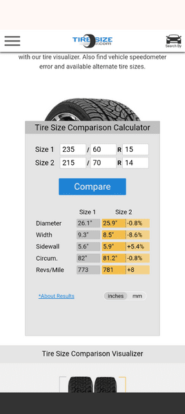

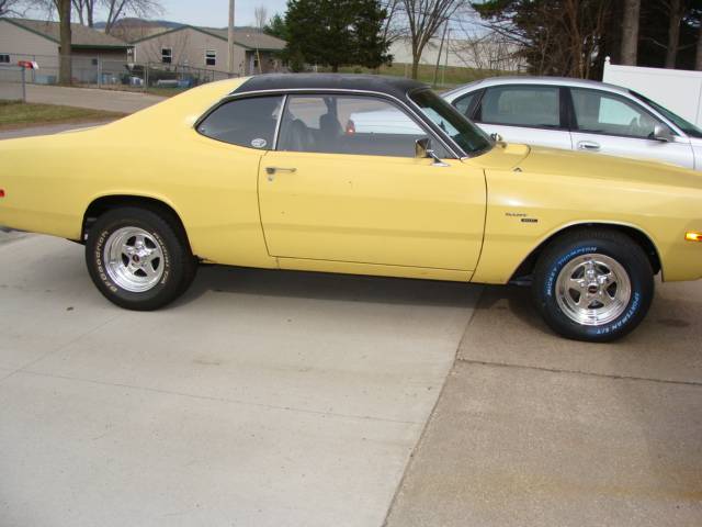

71 340 duster, 14" sbp rallys (5.5 wide), ran 225x70 14". Never had an issue. Now have 235x60 15" sbp (7" wide) iirc 4.25 bs ? No issues there either. Picture is with 15" all way around.
Your 60 series are only 0.200 taller than 215 / 70 -14
Op was asking about 215/70 15 which are 1 inch taller

Mine has Bfgs 215/70/15's on the front. Rub on passenger side when backing and turning at full lock. Drivers side perfectly fine but passenger on full lock reverse is iffy. I raised the torsion bars which helped and still small slight rub. Going to 215/65/15's next tire change for fronts. Suppose to be perfect size i have gathered with zero issues and i think would be perfect.
