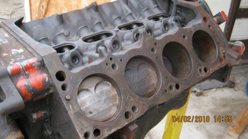

I could see one or two. But all of the commando cars here have flat tops. Even this never touched car from the original owner. Could it be a 66 thing or a 4 speed thing. All of the cars here are 67 autos.

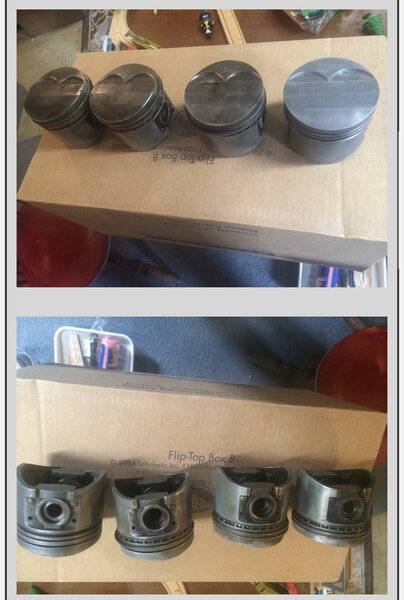

One original engine was removed and stored by the owner after installing a 340. it came with the yellow car. I have all the pistons Not one domed. I lost count of how many 273 commandos Todd and I have here. It would be mind blowing for someone to remove all the domed pistons from the engines here. These are commando cars and one Formula S coupe. All of them are E code
1st are those original pistons, or aftermarket? They look aftermarket. Oversize? For a long time 10.5:1 pistons were only available as custom. I've bought and parted a 67 Formula S in the 70's with 50,000 miles on it. It had domed pistons, I still have it. My 66 Formula S had domed pistons. I bought a virgin 273 Commando motor and trans from a member in the 80's it had domed pistons. Check an old Motors Manual or tune up guide from back in the day, they will list the Commando/Charger 273's compression ratio as 10.5:1. The 2 barrel motors will be listed as just under 9:1. The D Dart was so rare, most people do not know about it. Probably only 50 or so, but I do not know the number.
I've had 3 273 Commando's apart, a '65, '66 (out of my Formula S), and a '67, all three had the same bank specific, above the deck, pop-up pistons. I suspect when we see the flat tops appearing, in 273 cars, and keeping in mind how these cars may have been operated by their original owners, we may be seeing dealer warranty replacement short blocks that the dealer (or Chrysler) saved a buck on (or someone swapped the Commando/Charger short or long block out from under the intake and distributor). Since MOPAR didn't start matching numbers until years later, we only have date codes to know if a block or head is "correct" for the car. And of course it is also Possible (but I view it as less likely) that MOPAR ran short of the pop-up castings in production and used the flat tops to fill in the gap.

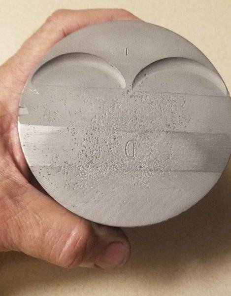

How did Ma Mopar get high compression out of a 273 if the pistons, rods,crank and heads were all the same. They didn't. They used domed pistons to raise compression.

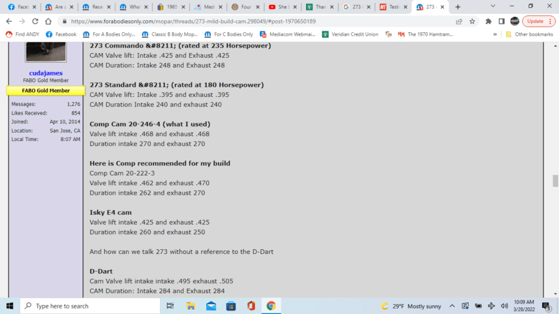

The 4 barre cam was bigger. There were some minor changes to the 4 barrel cam between the years. (not by much) 273 mild build cam
The 4 barre cam was bigger. (not by much) 273 mild build cam
Yep, My point was, I was wondering which cam was in those flat-top blocks:
Std. 273 2 Brl (8.8:1):
Valve Lift: 0.395" 0.395"
Duration: 240ø 240ø
Opens: 14ø BTDC 58ø BBDC
Closes: 46ø ABDC 2ø ATDC
273 Commando (10.5:1):
Valve Lift: 0.425" 0.425"
Duration: 248ø 248ø
Opens: 14ø BTDC 56ø BBDC
Closes: 54ø ABDC 12ø ATDC
Without at least checking lift it's tough to know what was actually in those cars.

Exactly. The 2 barrel .395 cam should have been in the flat top engines.
All of the engines here are 67 automatic cars. The blue primered car I know for a fact is the original engine never touched or out of the car. Bought the car from the original owner been in a truck body in Tennessee for over 35 years.
The pistons are the original pistons from the engine pictured from the yellow car. That car was purchased from member gtsjohn with that original engine came with the car. What I find it hard to believe is that every car we purchased with a 273 had the pistons changed. We even had a 4sp dart GT. Off the road since 71. How could I end up with all the cars with replacement pistons or engines.
There must be another reason for these engines all having flat tops. You would think either Todd or I would at least have one engine with domed pistons out of at least 10 cars and engines. I just don't get it.

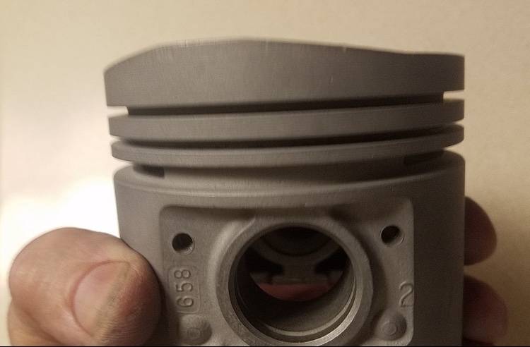

Pistons.....1965-1967 273 Commando engines had high dome pistons from the factory....10.5:1 compression engines....2bbl engines had flat pistons and they are different....here is a 273 HP piston
