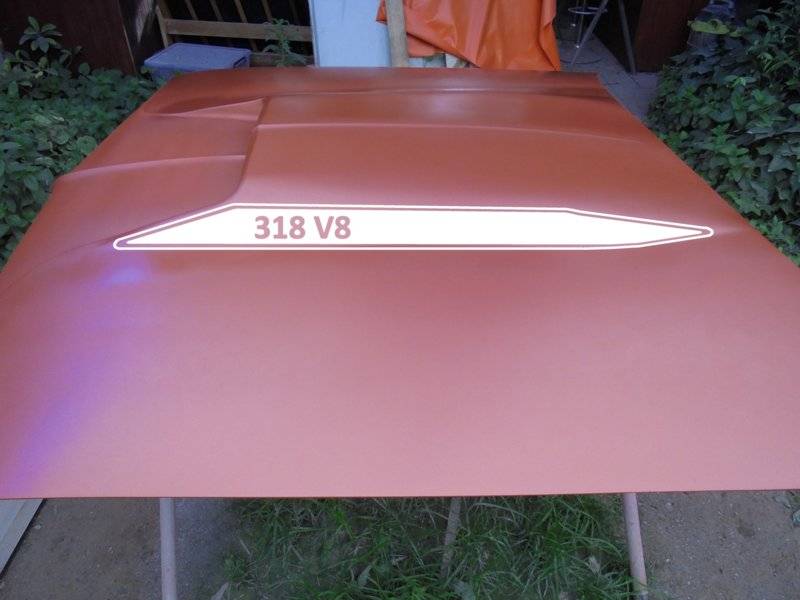

agreed, it was just to have something there, the sign writer is drawing it up now...the bumble be stripe over the rear has "Dodge" cut in, in Hemi head font as used by Chrysler in the 60's...he is using similar font for the hood stripe...we are doing a test graphics that I'll post once fitted...thought I may have gotten more comments on this...lol

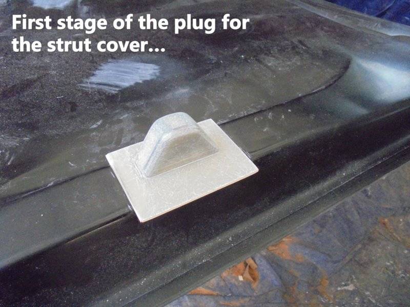

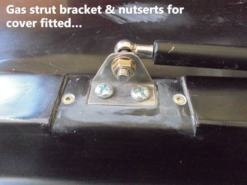

The test bonnet now has been filled with the expanding urethane foam, won’t do that on the bonnet I’m going to use! Cover plates for the gas struts and quick latches made and fitted, along with the molding….ready for fitting to the ute!
