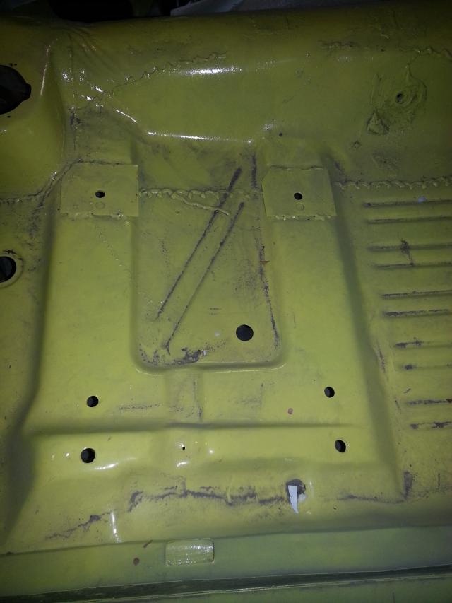

Bench to bucket conversion, need help please

so are two or four needed for each bucket?
Two, if you're going to be factory correct.

I used 4, because I've seen what happens to people when the seat brackets tear through the floor in an accident.

Cracks most often found at farest left side. Heavy driver in and out ? Clutch pedal operation ? Both ? Look for and repair any cracks found before recovering.
Its always good to reinforce when ever possible. When I put my buckets in I used plates on the top and body washers underneath . You want to sandwich the floor sheet metal . My seat studs were toast so I replaced them with 5/16 ready rod and made them long enough
so that I could level the seats use a jam nut to hold position.
ok, that makes sense. but wouldn't adding all 4 make the seat lean to one side?
In theory I suppose. The plates are only like an 1/8" thick though. I seriously doubt your floor is level within an 1/8". The tolerances on the frame/suspension points are only within a 1/4", body tolerances are even worse than that. Not to mention the tolerances on the seat.
