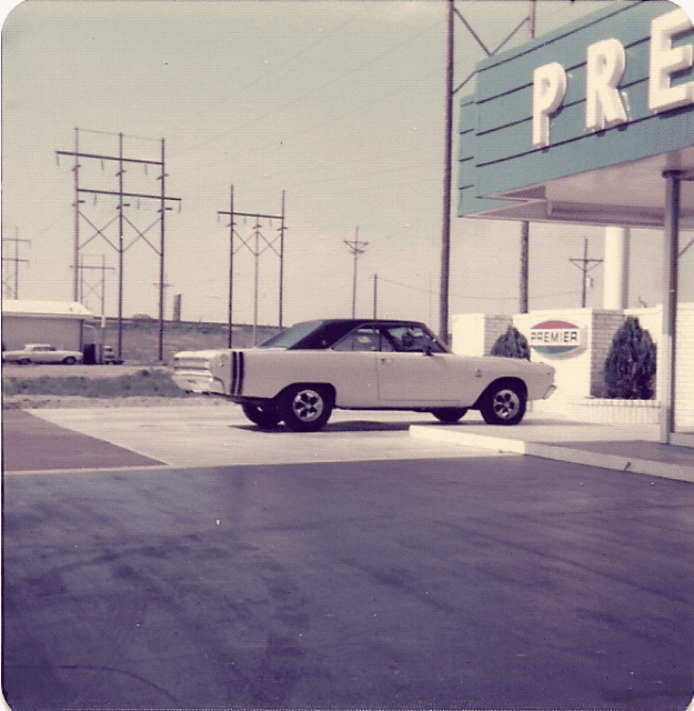

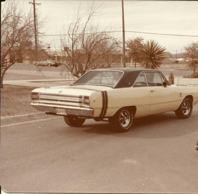

    Three year process. Amarillo TX car. Sold by the largest Scat Pac dealer in Texas at the time. I'm still researching the history on the car. Spoke with the family of the original owner and got a lot of history that way. Trying now to track down some of the previous owners. Here's the car in 78

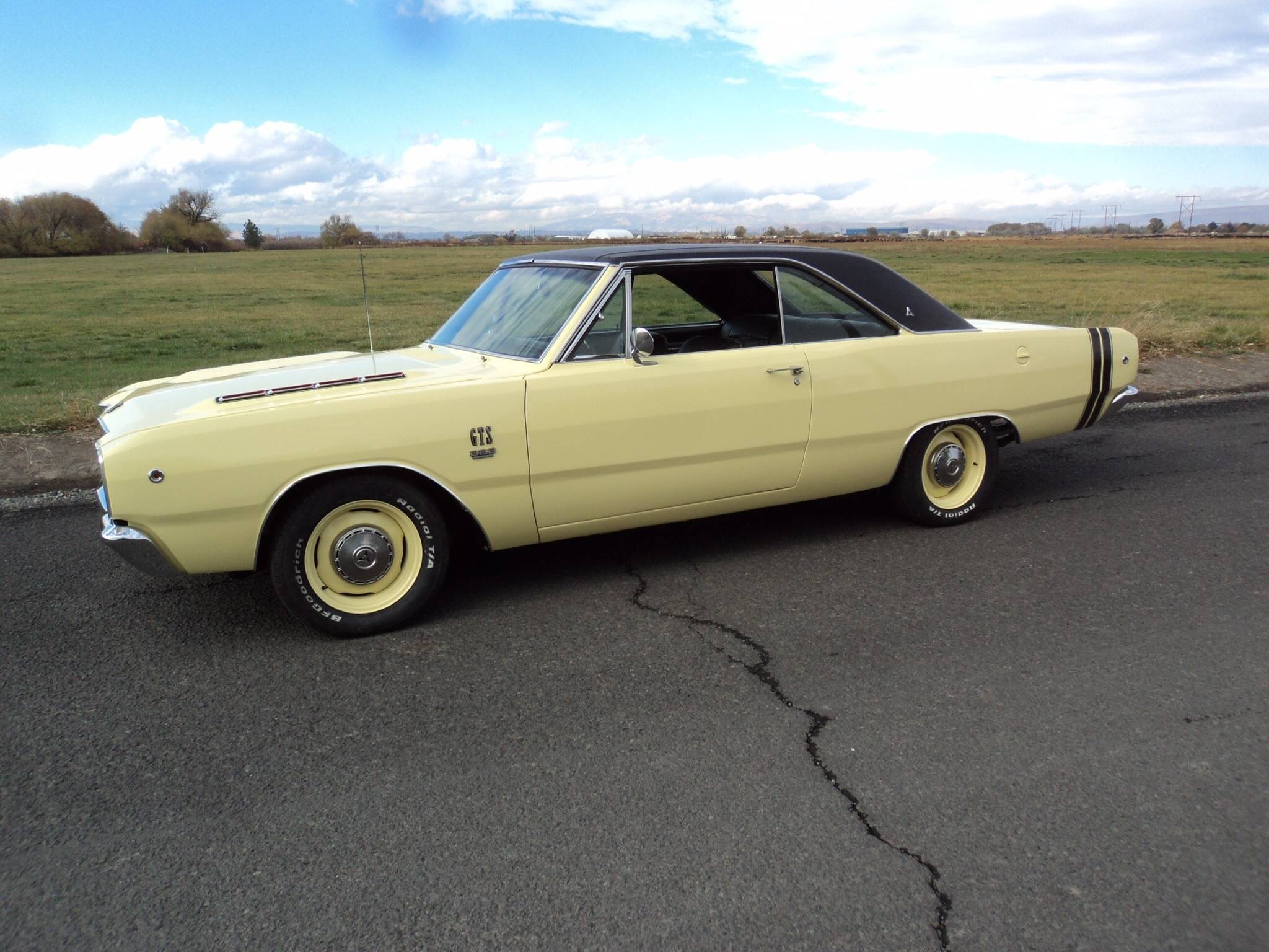

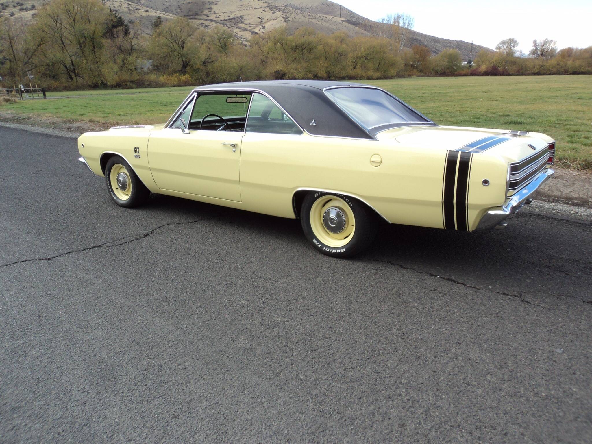

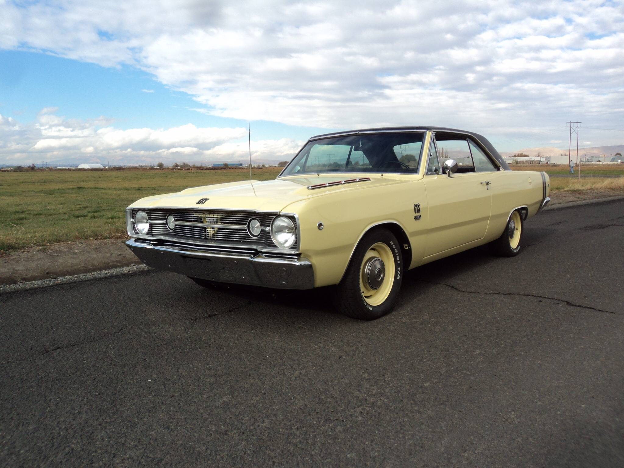

    And now

    Watched your build, that's gorgeous!
