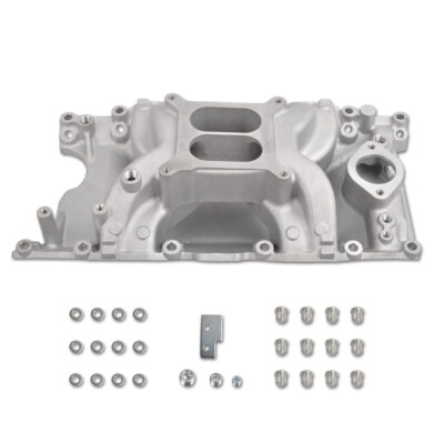

Old thread but spot on for my plans. I have a 56 Dodge pickup I'll mount on my 2001 Dakota chassis (9.25" rear axle, posi 3:55). Dumping the high miles (203K) but still running good 4.7V8 for a running complete low miles factory rebuild 5.2 Magnum I bought for $600. Then I bought a 8HP-70 trans from a 2016 Challenger with the driveshaft and TC for $400. I plan to mod the 5.2 with some Keith Black pistons, deck the block to near flush TDC pistons for about 10:1 compression, torquey cam, electronic/adjustable distributor, headers, etc. Should be a fun daily driver and may even get 20+ mpg on the highway. I'll do the kegger mods for better breathing. But also thinking of ditching the kegger intake and doing the Hughes intake for the EFI system. I want daily driveability and decent power, but some fun also.
Your gonna have to spin a 318 fairly high, probably at least around 7,000 rpms for peak hp of 500 hp, the kegger doesn't have enough cross section and runners too long for that much rpm.
Throw the kegger in the ditch. Air Gap and a 750dp will get it done.
Probably not that high. Maybe 6500 and that’s barely above an idle in 2024.
