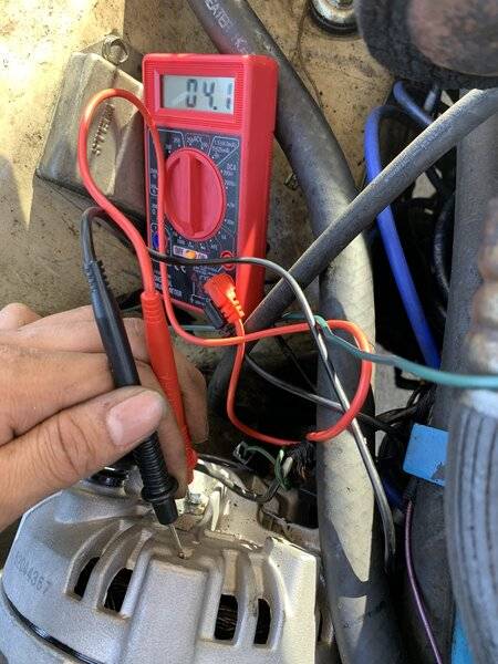

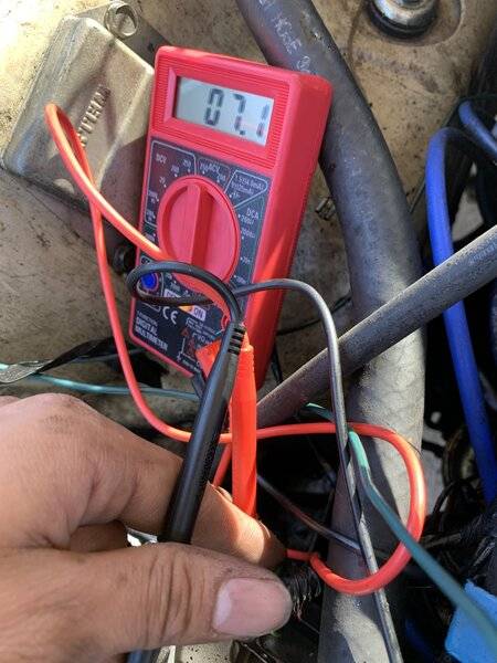

It reads around 3.9 between the 2 spades, 4.1 from green spade to the case, and 7.1 for the blue spade to the case. The numbers fluctuate greatly but that is the pictures of the most stable reading.
There's the problem. Neither field terminal should have any connection to ground.

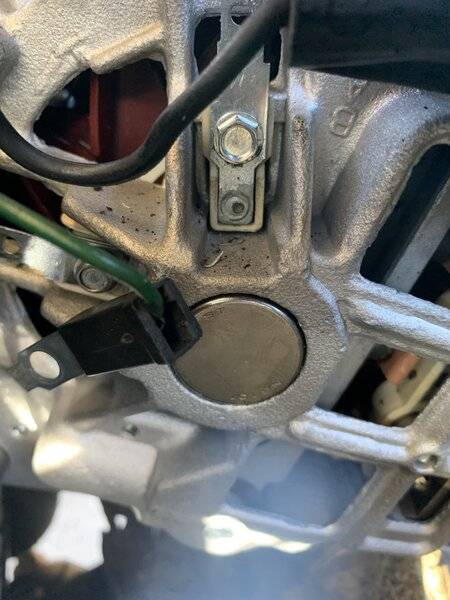

This may be a shorted rotor BUT IT IS ALMOST ALWAYS an issue with the brushes/ brush holders/ brush holder insulators. Take a GOOD look at the brush holders. Both should have shoulder washers to insulate the brush terminal. If you take your time take them apart one at a time, and re--check continuity to the case with one brush removed you can find the culprit. Most of us can tell just by looking
Back in the day, we would NEVER replace a nearly new alternator just because of a brush. You can still buy brushes if you can find them.

Look like steel washers to me, under those spade retainer bolt heads. I can't believe the number of re-manufactured alternators being sold this way. You're #4 I know about in the past month..
