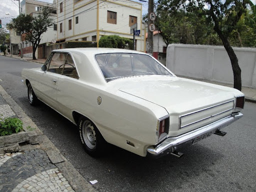

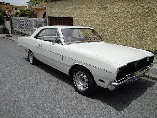

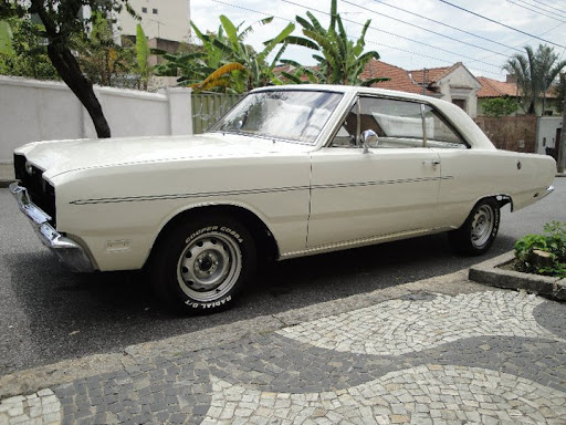

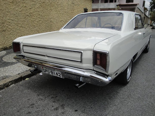

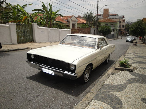

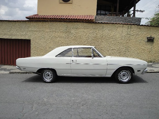

Brazilian Dodge Dart 76 (similar to 69 usa)
