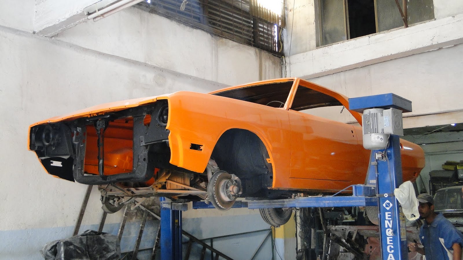

Have you seen this before, Alex:
[ame="http://www.youtube.com/watch?v=TLoBwj4ZO8g&feature=related"]The History of Brazilian Mopars - YouTube[/ame]
Some questions about photo.
What are tabs A for? We don't have them on ours(cdn)
Part B is the hood latch and post. Close up picture of one in and out of the car would be nice.
C is that fender flange bend. This measurment is to insure that the basic fender used is equal to a Cdn 1969 fender. 1968's are deeper,1971 etc are flatter.
D is the grill mounting tabs. Close up of these please.
A straight on view of the light bracket area E and locating measurement of a tab. thanks alex.

Hi
the "A" tabs are used to holde the air conditioner radiator
I´m uploading some picutres to help you

the hood latch
http://1.bp.blogspot.com/_sU88WoFEiCQ/TBe089IU9II/AAAAAAAAAfY/qixQJkM39XU/s1600/DSC01006.JPG
Thanks , Latch looks the same, so thats OK. Fender pics add more confusion. The one with the measurements looks like a stamped front. Not the weld on plate as the pic I posted. Pic of rear side of fender(inside) could mean I will be making a piece. I will be doing comparing and get bake to you.

Hi,
the hood latch and every think around it are exactly the same US model.
the fender has diferences.. the dart from brazil have the same fender, but the charger hast a stamped front, were the ligths frame I sent to you are welded. A friend welded these frames at a regular dart fender. He sad that he had to cut a piece to make possible to accomodate a light there.
I will try to take more photos...
I forgot to say.. the photo with measurements has the frame I sent to you welded there...

OK, so I'll use measurements for the weld on plate change over and not use the photos of the stamped fenders measurements. Knowing someone has made this work starting from Dart fenders is encouraging.More info on this please.
