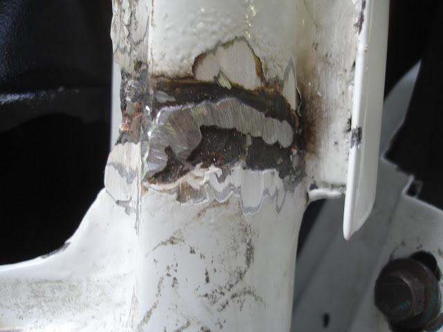

Driver side. I think I have a crack to work with.
Already cleaned area… drilled a hole at crack ends. The larger hole was supposed to be 2 distinct holes. Although, sheet metal broke.
welded in piece
Well, my weld skills are not perfect yet... but I´m doing the job.
Untill the weekend I will grind.
I see you leveled it out like i mentioned awhile back. I got a local friend who builds racecars who told me the locations to set the levels. I am glad they worked out for you. The subframe connectors should help with stress cracking you have found and welded up. Car looks great so far.
