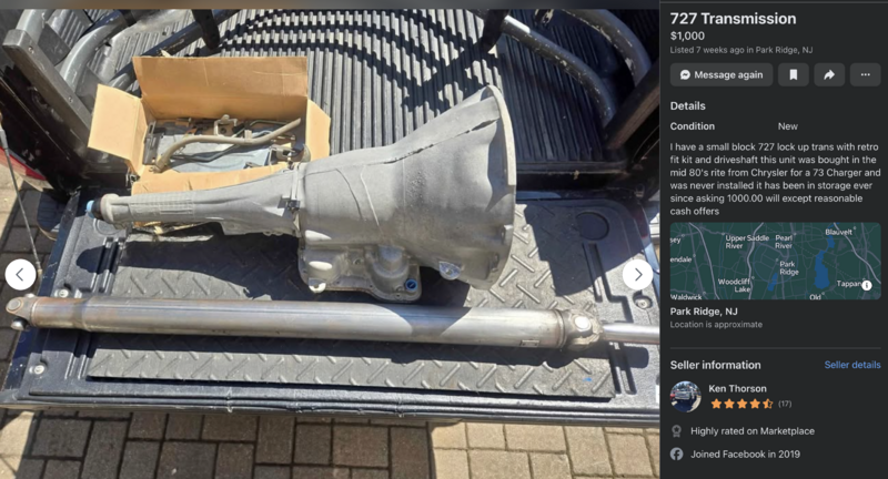

I would be wearing of spending that much on a transmission that I am not 100% confident in. Note you will also have to shorten that driveshaft.
Stock style timing chain is fine for this and is the cheapest. In fact, if you are a RockAuto user they have one by SA Gear in the closeout parts for a 2000 Ram truck for about $17, but you'd have to check shipping cost to see if it is worth it.
You will have to decide if that transmission setup is right for you. Personally, if I was keeping a tight budget and had no plans for a rear axle change, I would put a 904 transmission in it so it can retain the same original drive shaft. The description of that transmission kit says it was intended for a 73 charger. If that is true, the driveshaft should be too long for your swap, I think. You would have to verify that.
