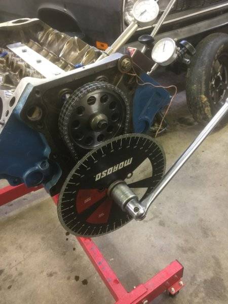

It’s always nice when you want to advance your cam 4 degrees and it comes in dead nuts on your first attempt. I ordered a new Cloyes Billet true roller timing chain over a week ago and don’t ask me why but things take forever to get here from Summit in Nevada and it wasn’t scheduled to get here till this coming Monday so I called and ordered a Sum-G6603R-B
78503-9R Summit Billet set. It’s a very nice setup with made in America on both pieces. I will put the Cloyes set up to use in my next build

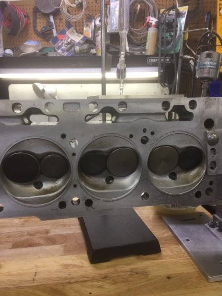

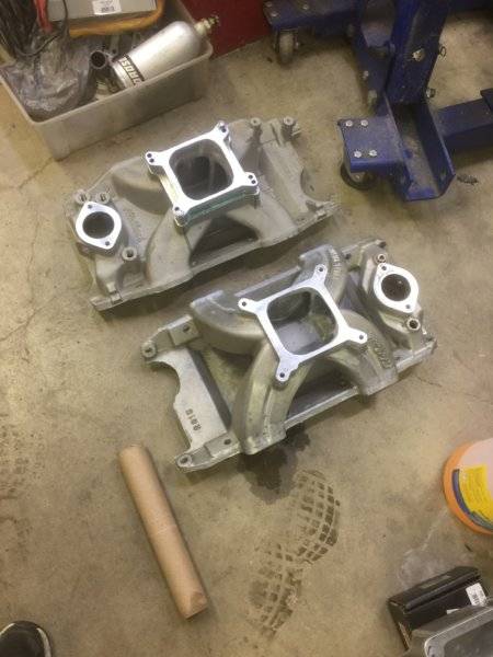

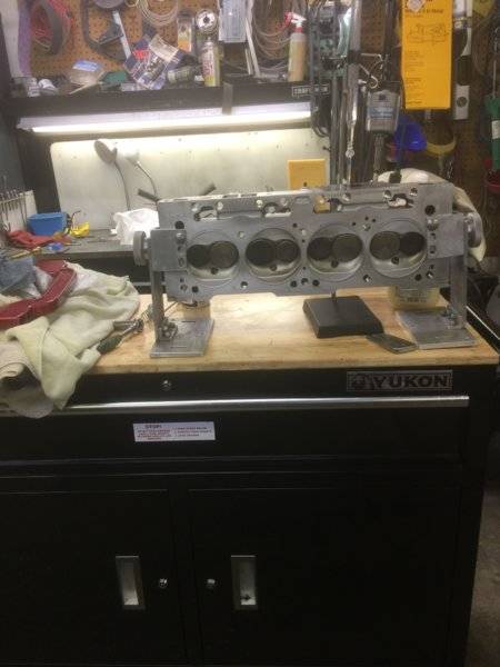

Well my ferrera 2.05 valves came last week but instead of taking the time to do some more work to this set of heads I’m confiscating my best set of Edelbrock heads that I loaned to my son for this engine since he’s not sure when he can race again. I never poured an intake runner so I did that tonight and it’s at 194 cc.
This set hit 318 cfm with a 2.08 valve and on my worn out 408 went 9.74 in my car and 10.03 in my sons Duster. I ran a Super Victor on this engine but being this is only a 360 I’m going to port a Victor340 I have sitting here for it.
These heads are an old set of open chamber 340 style that I bought damaged from a guy on Moparts for 450.00 then I spent 150.00 for the 2.08 valves
