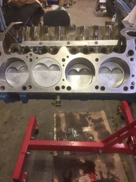

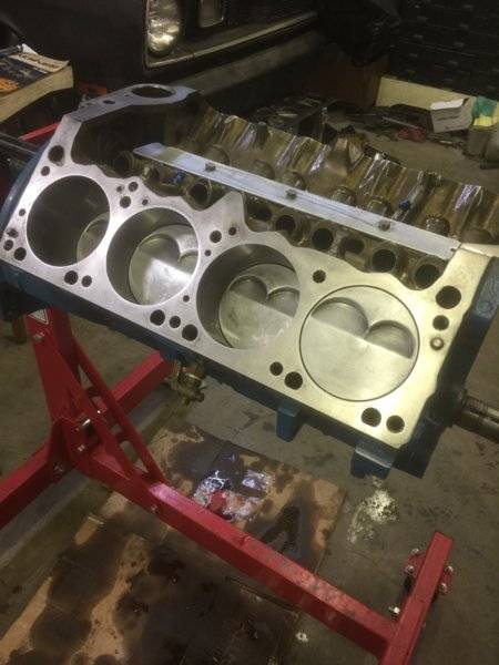

I finished the shortblock tonight except for degreeing in the cam. I have a couple of purple shaft cams that I lost the cam cards for so I am going to throw them in and profile them before I button this up so I can list them for sale
View attachment 1715296428 View attachment 1715296429 View attachment 1715296430 View attachment 1715296431 View attachment 1715296432 View attachment 1715296433 View attachment 1715296434 View attachment 1715296435 View attachment 1715296436 View attachment 1715296437 well my heads up car has been fighting me on my header install so it’s project change time. My plans were to next build a high compression 408 engine but funds are a little low so I’m jumping on a project I bought back in 2016 that was to good to pass up. Located about 80-100 miles from home I looked at and bought a set of .040 over Wiseco Pistons, Crower billet rods, roller cam and lifters, ATI damper, modified oil pan and pick up, stock 360 crank cut down to Chevy size and all internally balanced, and a few other goodies. When I went to check things out we BS’d for a couple of hours like racers do and he ended up offering me a 1972 360 block that this assembly was out of. He did some beautiful oiling mods and bronze bushed the lifter bores. I have about 1100.00 in everything as it sits. I will be micing the crank and having it magnafluxed while I clean up the parts and hone the block. I will get new rings and bearings and probably have around 1500.00 in the short block. I will top it off with a set of Edelbrock heads I ported and installed 2.05 intake valves in and a ported Victor340. Should run 9.80-9.90’s in the quarter and 6.30 in the 1/8.

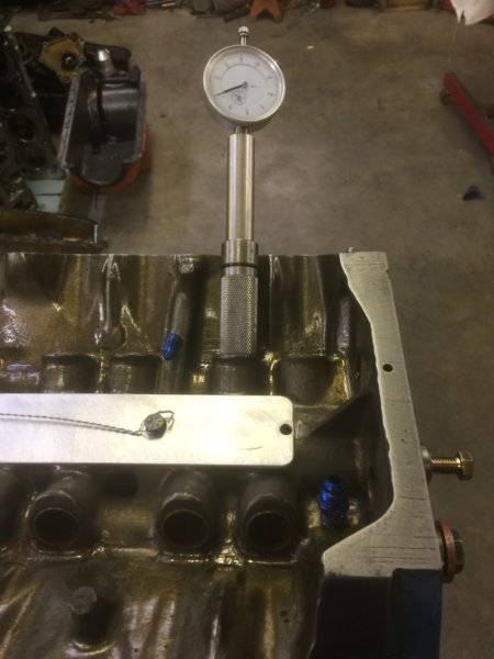

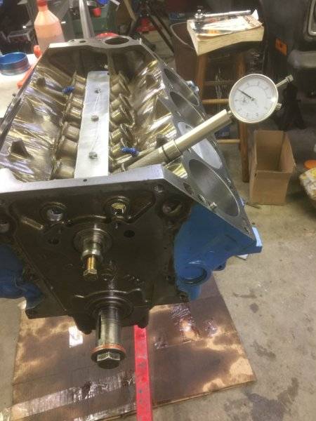

Kind of a laid back day waiting for 6pm Church Service but I did make it to the shop to throw two cams in this block so I could check lift numbers an identity them. After I did that I checked out the roller cam I got with this engine so the day wasn’t totally waisted. If you don’t have this tool put it on your Christmas list as boy does it come in handy for this job and degreeing in cams. Have a great Sunday
View attachment 1715312611 View attachment 1715312612 Kind of a laid back day waiting for 6pm Church Service but I did make it to the shop to throw two cams in this block so I could check lift numbers an identity them. After I did that I checked out the roller cam I got with this engine so the day wasn’t totally waisted. If you don’t have this tool put it on your Christmas list as boy does it come in handy for this job and degreeing in cams. Have a great Sunday
Ok I have quite a few indicators but that tool look Chryler specific.
Can you elaborate on the tool. I always use a lifter for that job.
They make them for both the Chevy and Mopar (.904) lifter bores and I’m sure others. I have both Chevy and Mopar as I’ve built a few Chevy engines for friends. I used to use lifters too but I saw this tool and decided to try it. I love it.
Ok I cannot put it on the Christmas wish list if I don,t know who makes it or the name of it lol.
compcams makes them for Mopars....bought my first one from MSI back in the 80s...makes degreeing in a cam a snap
Here's another one.
Proform Parts 66843
Engine Camshaft Checking Tool with Dial Indicator; Fits Chrysler Lift Bores
Not Yet Reviewed
Part Number: PRO-66843 More Detail...
Estimated Ship Date: Tomorrow
Apparently the proform one is a better deal. Is is a few dollars less and the one inch travel indicator come with it. The indicator is another purchase on the power house model.

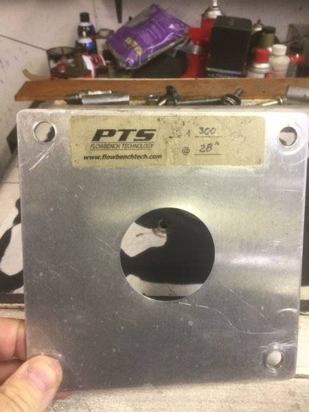

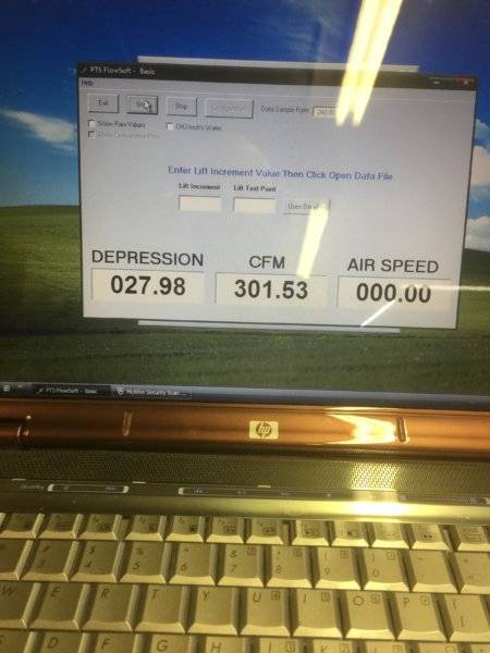

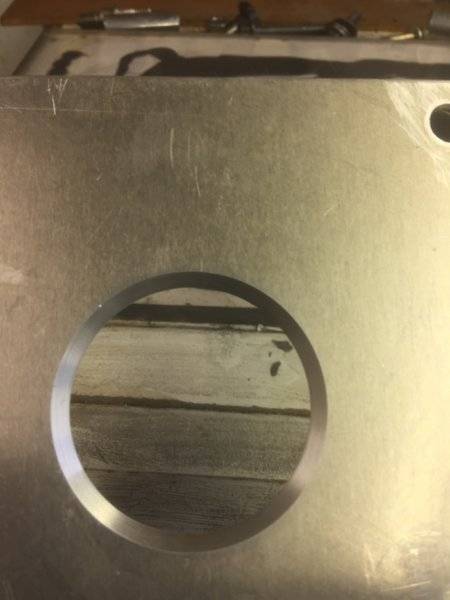

Well it’s time to port some heads so I spent two hours clearing off my flowbench that I haven’t used in well over a year. If you every see me comment on guys posts about their flowbenches being stingy or generous this is why I laugh. They make such a thing as a calibration plate to check and adjust your bench. If it is a bench that relies on manometers good luck with that because as the weather changes so will your numbers. Here is a 300 cfm sharp edge calibration plate made by Bruce that runs the flowbench forum
This was my test today on the intake side. To check exhaust simply flip the plate over, flip the calibrated plate inside my bench over, reverse the flowplate on the direction valve, flip two switches. (About 2-3 minutes).

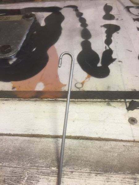

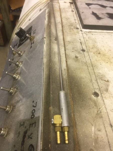

This is probably as important to me as flow numbers. I use these probes to map out my ports for air speed. Especially the short side. To fast, more port work to grab available flow. The straight probe is for the intakes and the u-bend probe is for exhaust

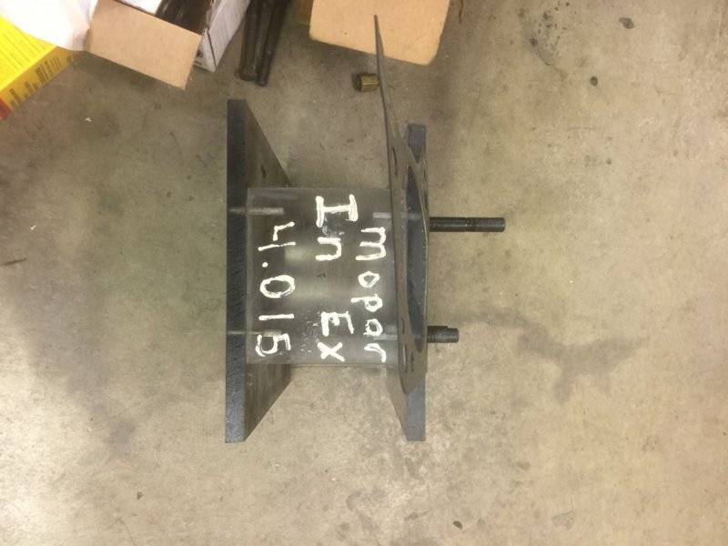

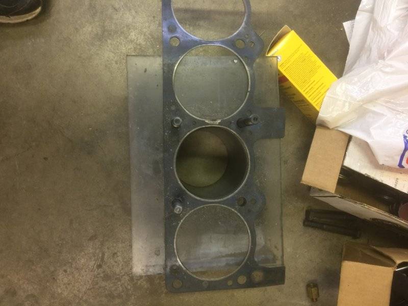

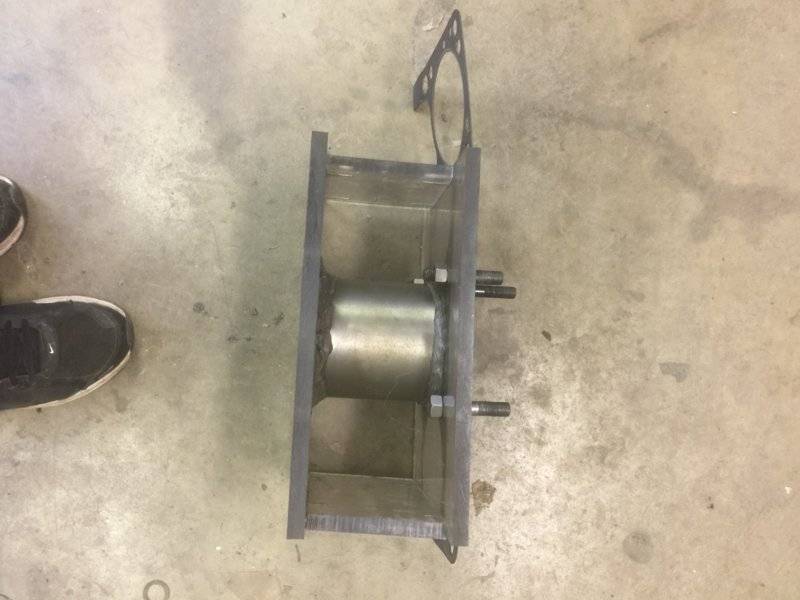

I made head stands out of 1/2 inch Lexan and cylinder sleeves I bought. They are laid out with head Gaskets so a little Vaseline and drop the head on the studs and bolt it down. I made up small block Mopar, two block block Mopar, (.030 over 440 and 4.500 big block) two Chevy sizes, and one small block ford.

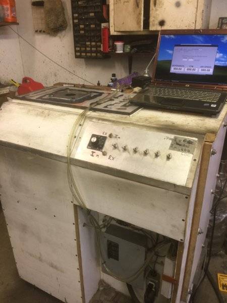

Excuse the messy paint job. After I built this flowbench I primered it and then tested it and I was off and running and never stopped to paint it. One of these days. This is my third bench and I built it exactly how I wanted it. 8 motors and I can flow most Heads up to around 36 depression if I am looking for an issue
