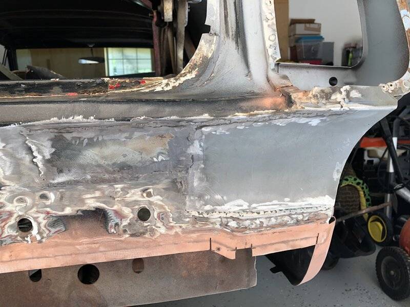

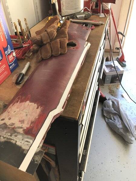

Another option is to clamp the old and new ones together then cut thru both of them at the same time this will make a cut that allows both the new valance and old valance to butt together with no overlap. You got to make real precision cuts for that though, and some careful wire welding.
I'll try cutting it between the ribs. I'm not gonna attempt the butt weld.

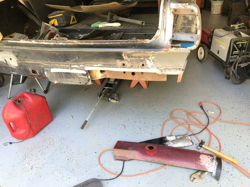

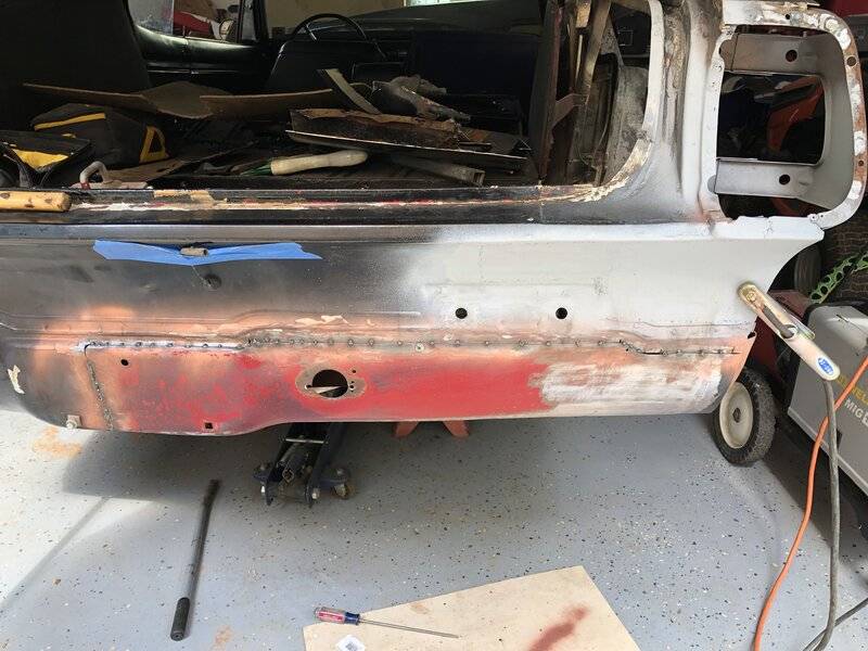

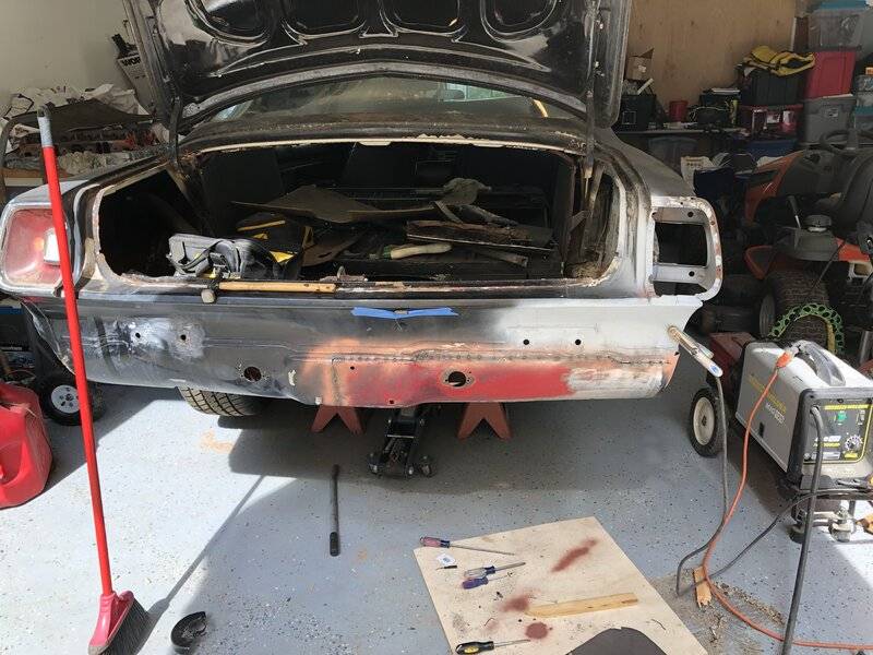

Well, got it trimmed down, held on with a couple screws at the moment. Wanted to get exhaust on to see how everything looked before welding just in case
Of course, not real happy with the location of the tips in the valance. I think the only real option is to modify the tailpipes and move them up closer to the frame rail to get rid of the 2 finger gap.
When your sitting on the floor staring directly at it I don't like it, but when its sitting on the ground and hidden by the bumper it might not be that big of a deal. But if I don't address it now it probably won't happen.
