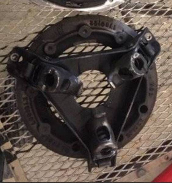

This is what the Auburn 9 1/2” pressure plate looks like. It attaches with three 5/16” special shouldered bolts that Brewers has, referenced by 66fs above.
The 10” Borg & Beck pressure plate looks like the one pictured in the post by Toolmanmike.
I have done this swap in my 67 Barracuda, it’s very simple. You need the pressure plate, the bigger disc and three additional special shouldered bolts. Everything else should be the same.
