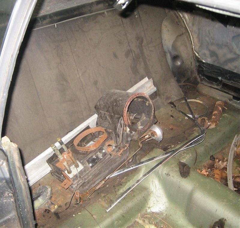

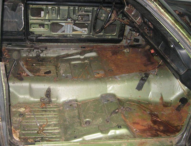

Well, its been a LONG couple of months. Pulled EVERYTHING out of the interior. Dash, seats, door guts, rear quarter ineer panels and guts, carpet, package tray, steering column, and all the wiring. Went through the wiring and rebuilt the steering column. New parts put in were the carpet, the seat covering, door handles, and window cranks. Everything else was rebuilt, reconditioned, and restored. Dyed the headliner, kick panels, package tray and visors white. Used SEM dye for this part. Use a Dupont flexible dye to dye the a pillar trim, dash and dash pad and some misc. seat belt covers and coat hooks to get the proper color of blue. Painted the insides of the doors and rear inside upper and lower panles in blue with a nice color from Duplicolor (Bahama Blue). Had the seats all recovered, picked up new carpet. Found a set of door and side panels and armrests. The end result is decent. I will post pics as soon as I can download them. I have a couple of what the interior looked like prior and a bunch of how it looks now. I also did some other work to the outside of the car too. New door handles, new mirrors, NOS emblems, complete new fuel system, new trim rings, new battery and cables. For now the car is done. If only the rain would stop???
Here is some pics. The top and bottom pic are from last year. The middle one is from today with all the upgrades.
