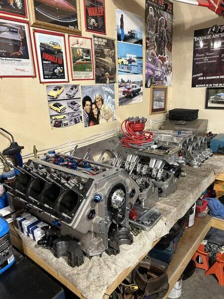

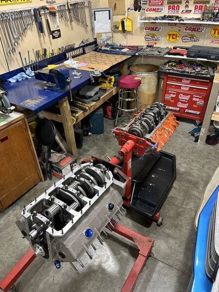

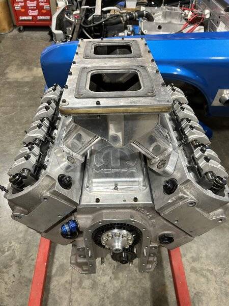

Yes I agree. We have 3 aluminum blocks. This is the small one at 414” and the big one is 477”. It also has W8 heads.
1 block is a spare in case something happens.

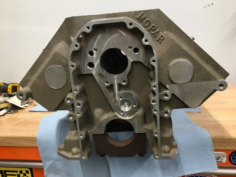

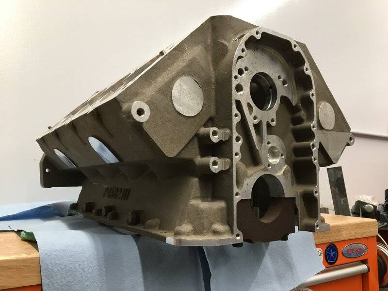

Who makes the aluminum blocks? Pics?
Kent Ritter has aluminum or iron small block race blocks.
That’s major eye candy

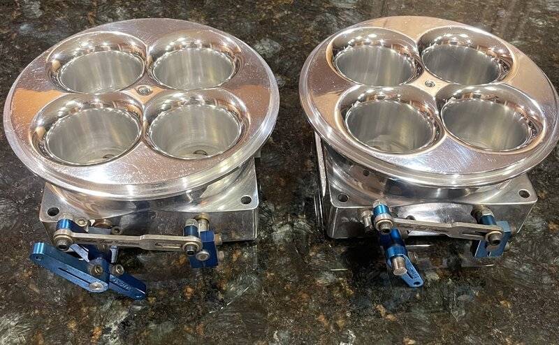

If you’re interested I’d let them go for what I have in them. Their kinsler throttle bodies I bought to do efi on my tunnel ram. I backed out of that idea and bought apd carbs instead. Otherwise I’ll use them on something someday. I would like to try MFI alky myself. How do you like it?
It would be nice to buy but I have the toilet set up already.
I won’t go back to a carb. I have no issues with the MFI. I have the primer plus system on my car so starting is easy.

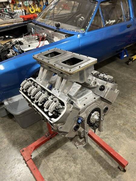

What are the specs on the 477?
I have two new A blocks on the shelf, w W8 Chapmans, 4.25" stroke, not sure they will ever get built, everything so bespoke to the build.
Considered doing a Ritter Alum block, that seems to be its own minefield.
I don’t remember all specs , would have to look them up.
Solid Aluminum block
Diamond pistons around 15.5:1
GRP aluminum rods
Nickens sheet metal tunnel ram
CFE W8’s
can’t remember cam specs but I think 850-870 range
