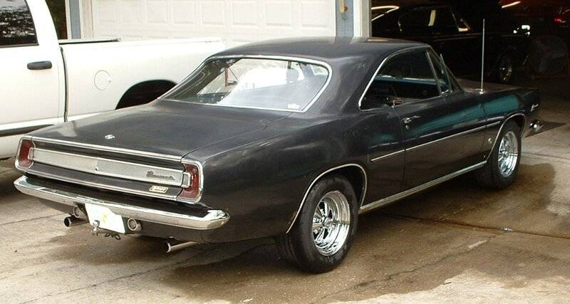

Crager SS 15x7 front 15x7 rear 68 barracuda.
Nuther pic
I mounted the rear tires myself, then put each wheel/tire on my bubble balancer. It said they were already perfectly balanced. I was kinda doubtful, given previous experience with Cragars dating back quite a few years, but a test drive showed it to be perfectly smooth. I don't know if I just lucked out, or if whoever makes Cragars now does a better job than a couple decades back. I know the chrome is holding up better than some of my old ones did.
Any mods to front end? I know that my fronts are VERY close to touching fenders. Looks great BTW!
Thank you. No mods whatever on my 67. I also have 15x7 SBP Cragars all the way around on my 63 Valiant convertible and my 65 Barracuda. Both cars running 225/60/15 tires. I did have to trim the left front lower fender lip of the Valiant. The trim was so slight that it's not noticeable. Didn't trim anything on the 65 Barracuda. And the 67 has more room front and rear than the earlier As.

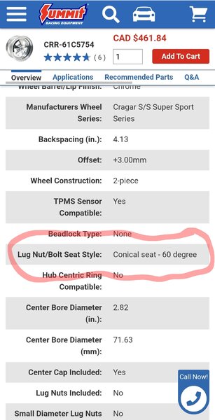

Thank you for the info.. one thing I noticed is on summit racing, the specs for the rear 15x7 cragers states they use conical nuts. Yes im still running LH lugs.
That’s what summit says, but Cragar website says otherwise. I believe I have some new LH nuts for that’s till if you’d like me to look let me know
Or you could just wait ans Ee what arrive to be certain then get your nuts?
Ill check out crager website. I'll keep those nuts in mind.. thank you

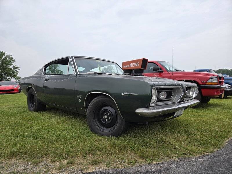

He's a current picture with original wheels..
I love the Steelies, just looking for a different look... thanks for any advice on front tires.
Next will be correct lugs and probably have to swap out the Left hand to Right hand. But thinking I might wait until wheels arrive to confirm lug seat configuration..
Thanks
You can probably run 215/65r15 front. You may have to lengthen the fender brace support bracket
From the looks of it you have ss springs so the 8" rears with 255’s will be fine
Im looking at the cooper cobra tires. Seams like 215 65 15 are my only option. I currently have 215 70 14 on original Steelies that I think are 5.5 not sure on BS , but I have no rubbing issues..
Check my post above, your front Cragars are identical to the Steelies I have now.

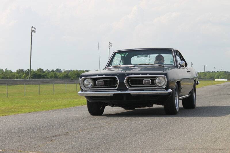

My front wheels have all the tire that wheel can have on the front of a 67-69 Barracuda, in all driving conditions, no cutting or modifying of anything.
