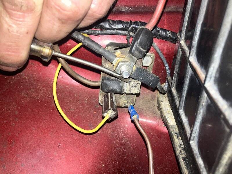

From inside the car, I turn the key and the starter spins over slow. When I take a screwdriver to the relay…
It cranks over as fast as you’d expect.

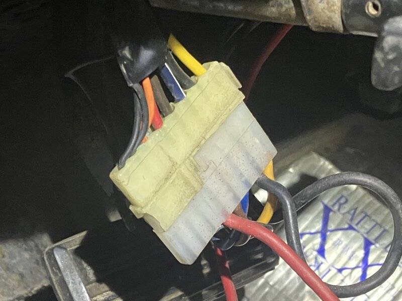

I’m going to slip another ignition switch plug into the dash harness to see if I can rule out that. Next would be potentially corroded bulkhead wiring terminals.

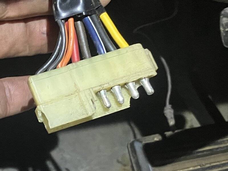

I tried a different ignition switch and it didn’t make a difference. It spun over at the same speed. It was enough to start the car though. The wiring terminals…
Here you can see the dash side plastic plug is broken on one edge.
The wires are remarkably clean looking though.
For now I just put a zip tie around the connection to keep it from slipping off.

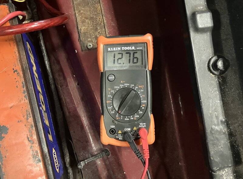

Testing the battery voltage when cranking and noting what it reads with a slow or fast crank might give some clues. A bad brush or bad connection should cause a difference in the load on the battery that should be fairly easy to spot.
Last week I had the car running where it is sitting in the picture. My nephew was in the car and smelled something, I saw the voltage regulator was smoking. I replaced the regulator, both battery cables and starter today. I started it up and saw no smoke anywhere. It ran fine, it just has that weird intermittent slow cranking issue.
I actually pulled the mini starter that I had in the car and put in a stock one. I love the sound of the stock starters but forgot how close the terminals are to the exhaust pipe. I have a 340 manifold on the drivers side with a 2 1/4" pipe on it. There is about 1/4" to 5/16" of room from the big lug to the exhaust pipe. I swapped in the old starter just to have that classic sound but I may switch back to the mini just for wire clearance.

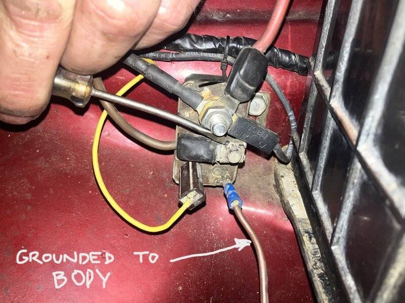

I do have the terminal with the brown wire grounded since when I patched this car together, I didn't have the wiring that went to the neutral safety switch/backup lights.
I'll try running 12 volts to the yellow wire/terminal.

The problem is in the relay. In post #1, the s'driver is essentially shorting out the contacts inside the relay. Note that even with the contacts bridged, the current is still flows through the SAME wiring & connectors. So if it spins fast with the relay terminals bridged, then it cannot be these items causing the problem. The relay contacts maybe burnt from arcing or worn way. You can buy a 150 amp relay which comes as a black cube, only sligthly bigger than the popular Bosch 30 amp relay. This is what I use for the starter relay. 150 amps is waaaaaay more than the solenoid draws but it means the surface area of the contacts is greater, resulting in less arcing/wear.

Assuming all other things are good. When you short, with a screwdriver, the battery terminal to the starter solenoid terminal you eliminate the starter relay.
Nothing in the cars wiring would create a slow cranking situation EXCEPT a massive load like the headlights on or other large load.
The battery provides power to the ignition switch, from there it goes to the starter relay.
As long as there is enough power to engage the relay the relay will make the same connection the screwdriver does.
The proper way to test the relay would be to provide a switched 12v lead to the yellow wires terminal on the relay with the yellow wire removed and the key in the off position.
If the engine rotates as fast as with a screwdriver it's NOT the relay.
Next turn the key to run and do the same test, Take note of the cranking speeds
Next test for a massive load.
Get an amp meter and check the load from the battery with the key off, run, and with the yellow wire disconnected, start.
Note the amperages.
There should be no draw with the key off.
There might be a slight draw in run.
And with the yellow wire disconnected there should not be any significant change when in start.

Everybody needs to re-read post #1. When he shorts the terminal on the relay [ brown wire coming from the ign sw ] to the terminal with the red wire [ red wire goes to starter sol ], the starter cranks fast.
Nothing to do with the wiring or...headlights being on. The relay is faulty.
Look again at the photo... the yellow is the only wire that comes from the ignition switch.
The brown wire goes from the starter relay TO the solenoid/ bendex on the starter, the red wire comes from the battery to the terminal on the starter relay and FEEDS the car through the bulkhead (and takes charge from the alternator to the battery) the starter motor gets it's power from a heavier wire directly from the battery to the solenoid/ bendex
By screwdriver jumping those two terminals the starter relay is removed from the circuit.
If he provides +12v to the yellow wire terminal, the relay acts like it does when the key is turned to start (minus the ballast bypass) and the relative IS in the circuit.
THIS makes sense. Thank you.
Electrical stuff has always been my weakest point.
I was under the incorrect impression that by crossing the terminals, I just bypassed the ignition switch and bulkhead wiring alone. It never occurred to me that this was also bypassing the entire function of the relay itself.
