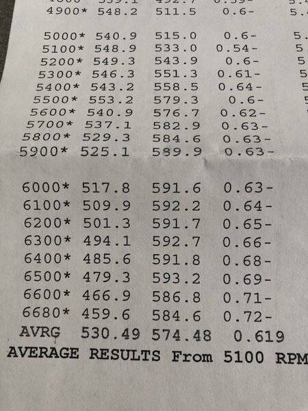

I dug out a sheet a customer sent me.
408 w-flat tops, TF heads with some rework, Wilson ported SV intake, PRH cam, 1.6 HS, E85 Book carb, 1.75-1.875x3.5 dyno headers:
Wonder about the extent of the 'rework'. Even then it's done around 6000.
Here's a question for you. The TF head 'wing' has a big affect on anti-swirl and I would imagine helps with wet flow. How would that impact a dyno run? What are the things to look for? Torque increase at lower rpm?
Those heads had the entire port “touched”, and the swirl vane removed, but that didn’t improve the flow any.
(I didn’t do the rework of the heads, but I did do the final valve job & assembly.)
How that impacts the dyno results….. there would only be one way to know for sure……..and that didn’t happen.
I consider that power curve very solid thru 6500.
