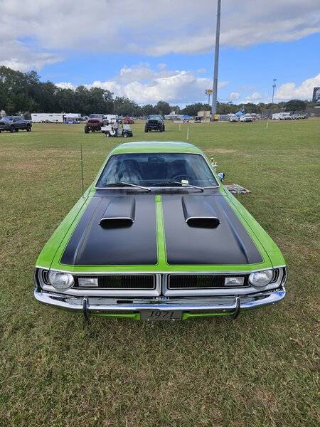

I was wondering about the performance gain of the twin scoops if any versus no scoops . Did the Chrysler engineers test these or are they more for looks ? I was thinking about making the 4 inch holes just a little bigger if these scoops actually draw cold air in. Thanks all that reply
They really didn't add much. There was an attempt by Chrysler to make them functional by adding two plastic tubes that fit in the oblong openings in the air cleaner, but attaching them to the engine then trying to make them go into the rubber grommets in the hood when closing it was not easy so they decided it would not be worth the hassle. I have seen a pair of the prototypes...

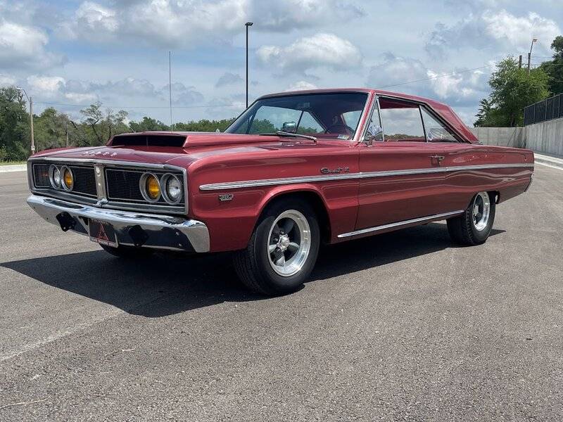

On A bodys they were strictly for "appearance" It would have been cool if Chrysler had designed a "ramcharger" setup like the B bodys used, but probably cost prohibitive
I guess that would explain the location of the 4 inch holes .

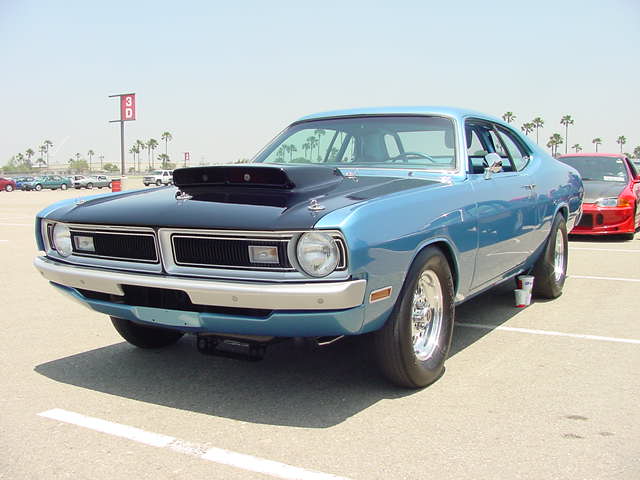

Since we're talking scoops, what is everyone's thoughts on the six pack hood short vs tall?
I've got twin scoops (non functional) now but am going with a taller intake that will require a hole in the hood. I've been thinking about using the taller six pack scoop. Does this get it up into the air with positive pressure? I like the look of them and I figure if I'm gonna have to run a single scoop, it ought to make a statement.

However, even on the B-Body Dodges with the Ramcharger set up they were not very effective.
For the power that they supposedly gave, they weren't probably worth the added weight.
They were a sales gimmick for the most part.
The problem was that they were trying to capture surface mounted air movement, and other than at low speeds, there wasn't much to be had.
Now, the Six Pack hood was very effective on the '69 1/2 cars because the opening was big enough and above the boundary layer in the flat part of the hood.
This is what I read in the Direct Connection book years ago.

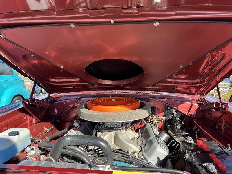

My opinion on them is that they look fantastic and on an A-Body, and with one that has the 4'' holes under them in the hood, they might be functional in the way that they would let hot air out of the engine compartment in slow moving traffic and cause some underhood circulation to take away some heat at normal speeds.

The Snorkel and T/A scoop were the only scoops that forced air but you need to seal them to the breather . They were not as efficient as a pro stock but kept the factory style look. My one 69 coronet R/T came with the twin scoops . The first thing I did was installed a lift off Bee hood in 1974. That was my second R/T and came with a Six pack engine Dealer installed new with the twin scoops. All my others had the bubble hoods even my convertible.

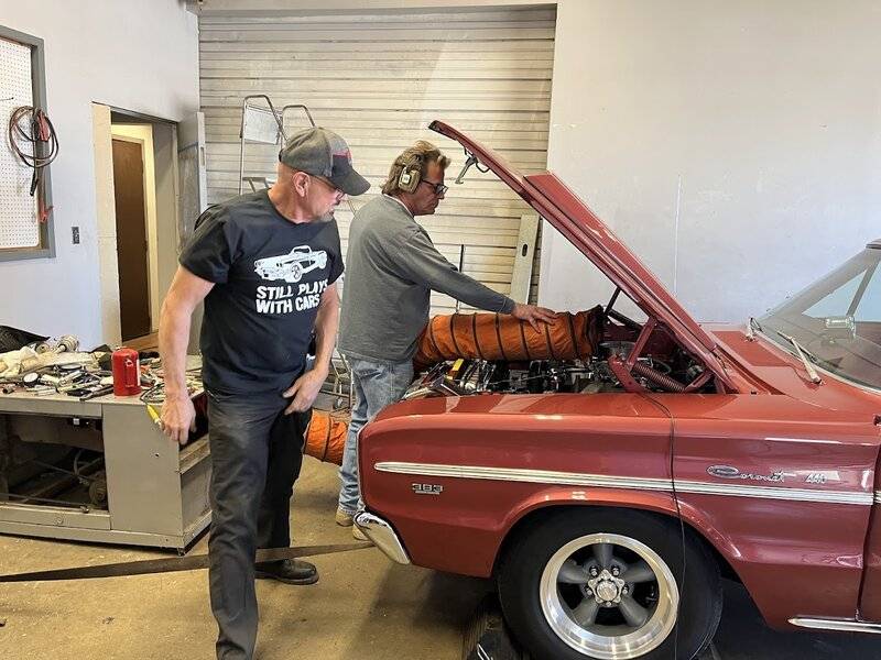

We noticed a rather significant gain (5-7hp) on the chassis dyno when cool air was directed at the carb during a pull. My buddy tried to recreate that by sealing his carb to the hood. Now, I'm concerned that with the boundry layer that Cracked mentioned above, this all may be for nought?
The twin scoops while they didn't do anything were a distinguisher from the base model Dart it identified the performance model probably more marketing than anything along with the tail stripe go wing etc. That being said I always liked the 68 Hemi Dart Pro stock scoop. While I dont see any "ram air" effect from the Swinger twin scoops I do see where it is a fresh air source or maybe it flushes the engine bay of excessive heat. That would be the only gain I see from them.
The scoops were an extra cost option on 340 Dusters/Demons.
Strangely enough they had holes in the hood on the Demon and
a rubber gasket around it BUT were cosmetic only with NO hole
on the Duster. They were standard only with the "Duster Twister"
(Still no Hole) BUT it was only available with a 318 and NEVER a 340.

I had them sealed to my carb, if sealed your car will draw cooler outside air but there is little to no ram effect.
