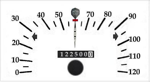

is that a white gauge overlay?

I wont recommend or install any other than those products from PremiumDashDecals.com If they don't offer white screens for your particular panel, that's too bad.
I don't know what other vendors offer or who does sell the cheap paper stickers I've seen. I do know they are exactly that.
TrailBeast.........I like what you did with your speedo overlay. The "Dart" @ 60mph is pretty dang clever 8)
