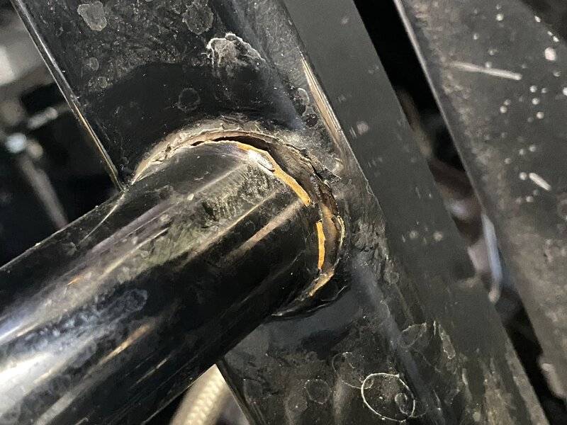

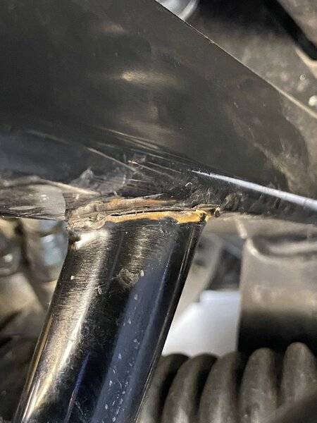

Looking at this pic, it looks like it was never welded properly in the first place.
Look at the rust around the circumference of the tubing.
Looks like water got in there.
Junk.
Run, don't walk away from this ****.
