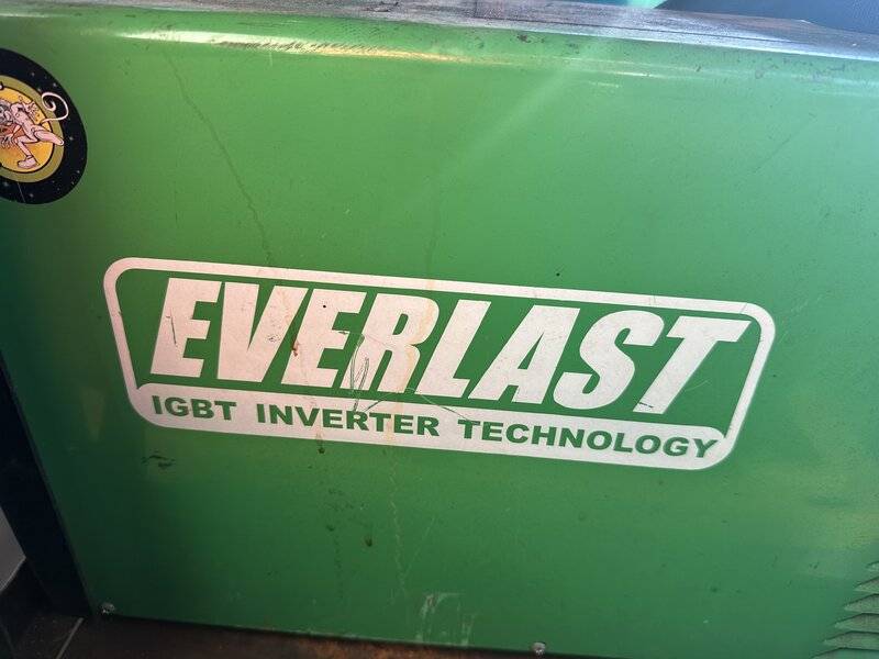

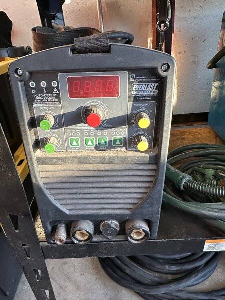

I’ll open another can o worms here. If I had the 6 pack and wanted to use it on mag heads, I’d drill the intake in a heartbeat. I’d fill the La holes with the old everlast green machine and hand drill the flanges to 3/8. The 5/16 bolts will drop right through with a washer. Doesn’t even have to be very precise. But I’m not a sticker for resto stuff.

Just so we’re clear the “everlast green machine” is my tig. It’s green
