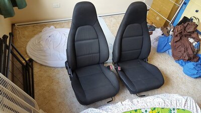

Eunos roadster, miata/mazda mx 5 seats, I have seen fitted
Its a narrow bucket from a tiny car, with tip forward and recline back base model cloth to high end leather...
heated in some cases as well
couple of sets here for ya, to illustrate what i mean
Fancy re trimmed later model
Black Leather Seats Mazda MX5 high back new MX-5 mk1 Eunos Roadster pair | eBay UK
early rough

tombstone shape like a 68 charger but not sized like a couch and they don't weigh half a tonne each
they sold Miata mx5 in the US from 1989 craigslist should turn some up, rust belt states will have rusted out miatas you may need to spread your net to find
metal shell and foam rather than creaking springs and hessian

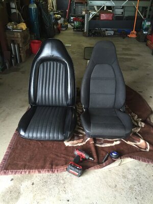

compare mopar bucket and miata seat picture stolen from FBBO
shorter base narrower base similar style if you did the pleated insert you could fool a man passing on a horse....
