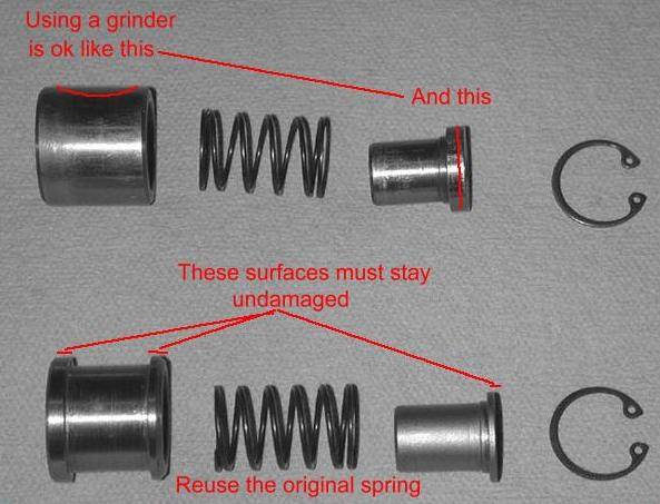

Correct, and the governor valves can be ground down to raise the shift points, or a different set of valves can be ordered from A&A transmissions.
Note the difference of the bottom valves compared to the top ones.
The idea is to make the valves lighter so they don't move until later in the driveshaft speed.
I have done a few sets before.
