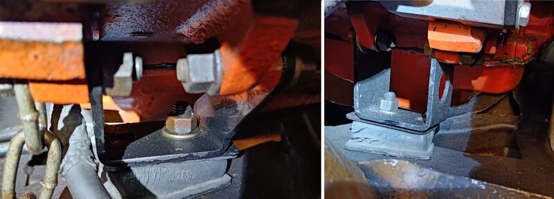

I'm chiming in on this topic. I have -65 Valiant with 360 swapped into it. Motor mounts are totally shot, and need to be replaced (they probably have hard time handling the blower torque). Can I replace the 2265 mounts with 2469 (they seem to have locking tabs which could help with the engine twist) or even with Moroso solid steel mounts? Moroso 62540 Moroso Solid Steel Motor Mounts | Summit Racing
With the 273 style Brackets 2710 (Napa 606-1653)biscuits from a diesel '90 W250 are close to the correct thickness and have locking tabs. The hole in the mount for the alignment pin has to be moved a bit.....
2469 aren't thick enough and let the engine sit too low.
With the Shumacher conversion mount the 2469 may be thick enough.

Thanks for the info! I'm genuinely surprised how difficult it is to find information about the mounts. I can't find any official info about the thickness of 2265, my local dealer tells me it's 36mm so that would be hair under 1.5". Rockauto tells me that 2469 would be 1.5" and 2710 would be 1.75" thick, so that makes me second guess the info from my local dealer. I need the replace the mounts with something ASAP just to get the car back on road, so maybe I just order pair of 2265 and try to look into the mounts and brackets with time. I would like to get either solid steel or poly mounts, but the options seem to be very limited. Looks like Moroso steel mounts are only 1" thick so they are probably way too low anyway. Maybe best long term solution would be if I try to source the 340 / 360 brackets and get poly mounts from Dodge polyurethane engine mount

I call them block insulators and they are the same on all LA blocks, I believe 72' and down, then they used the roll mounts (different "K" member W/loops). It's the mount to block tabs that are different on the applications 273-318 or 340-360. I would not use a solid mount on a street motor. I had issues with breaking mounts (drivers side) in my 72' Van with a 340. I installed a chain at the mount to engine and the corrected the problem. I believe a solid mount would be hard on the motor, the frame and my body. On my van, I was able to tweak the tabs (318) to accommodate the 340, but they are longer on the van than the cars, so it was easy to adjust.

I just purchased the Pioneer engine mount 602710 for a diesel truck from rock auto, under $12.00 and all you have to do is drill another locating hole in the bracket. The mount looks good and has the locking tabs.

'67-72 V8 mounts are the same, but '64-66 V8 mounts are thicker. Block mount brackets are also different between early and late.

Thank you all for the comments! I think I'll order pair of both 2265 and 2710. I'll try to fit the 2710 first and if something does not work, I'll have the 2265 as backup.

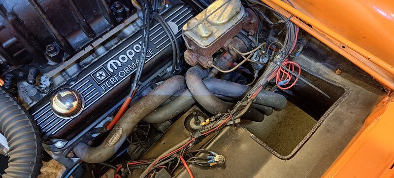

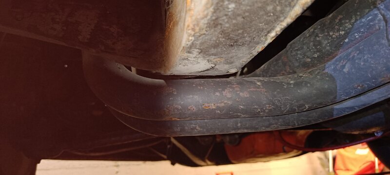

Well, just like everything else with 60-year-old heavily modified car, this won't be as simple and straight forward as I had hoped it to be. The car has Hooker headers where on drivers side three of the tubes go over and outside of the frame rail, and then curl back under the rail. There's is maybe 1/4" room for the engine to go higher. I don't even know if I can change the 2265 mounts without removing the headers from the engine before, and with new and intact 2265 mounts I'm worried that the pipes will start hitting the frame.
