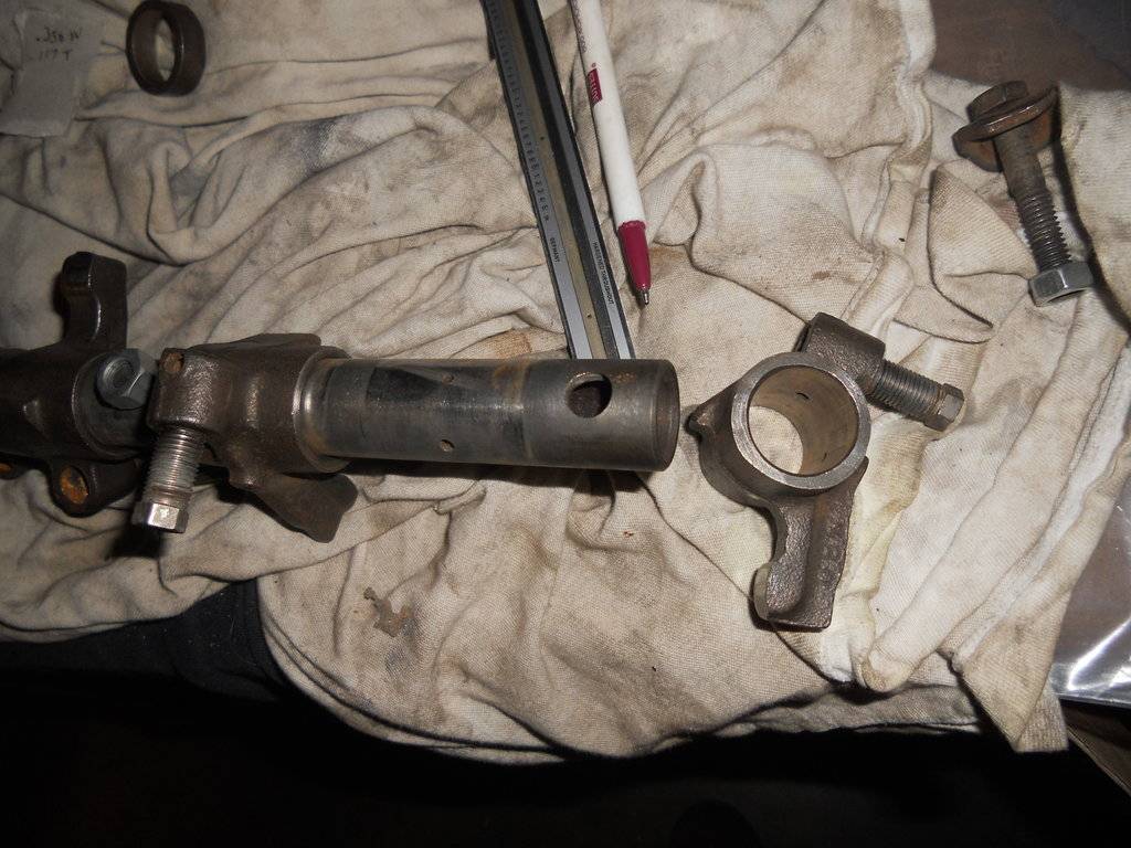

Ring width =.350"
Ring wall thickness = .117"
Also, you should drill the 2nd hole in the shaft behind each rocker if it is not there. This helps feed the hole in the adjuster side of the rocker, which then dribbles oil down past the adjuster and into the pushrod cup. For high revs, it is a must IMHO.
That 2nd hole is about 80 degrees around the circumference, up from the bottom oil hole in the groove, and to the adjuster side side of the rocker (which would be the uphill side of the shaft). It is .125" diameter. You can see it here; the shaft is upside-down in this pix.

You mean a groove like this? What is the best way to do this?
that notch in the end of the shaft in the picture faces down and to the left as your leaning over the fender installing them. That positions the oiling holes where they need to be, supplying oil where it is needed so the shafts and rockers don't gall up. THIS IS VERY IMPORTANT. If not done correctly the rockers and shafts can actually weld themselves together. No bueno. I've seen it, it is not pretty.
