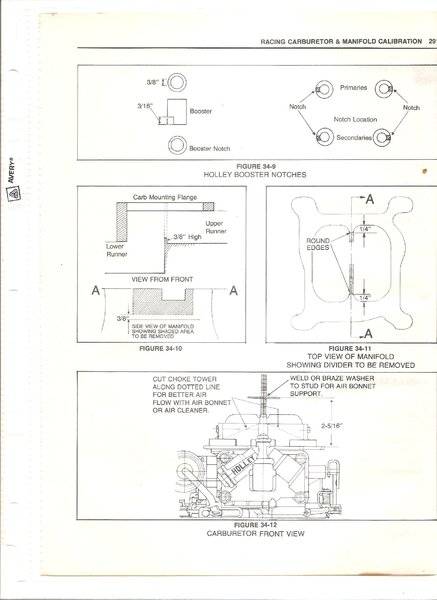

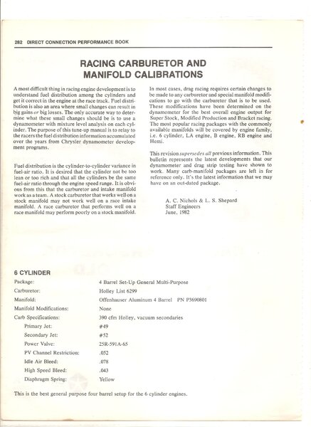

Went through all old DC and Shepard books. They all state the notch was for performance improvements on Mopars determined by dynamometer results. LD340's came with the notch when I bought them. Rounding the leading edge was required

Intro page in this chapter and the LD340 page with instructions. These mods were all done using dynamometer tests as per intro. Shepard book goes into more detail if needed. Looks like the wall is removed but shows notch was there before hand in this Figure
