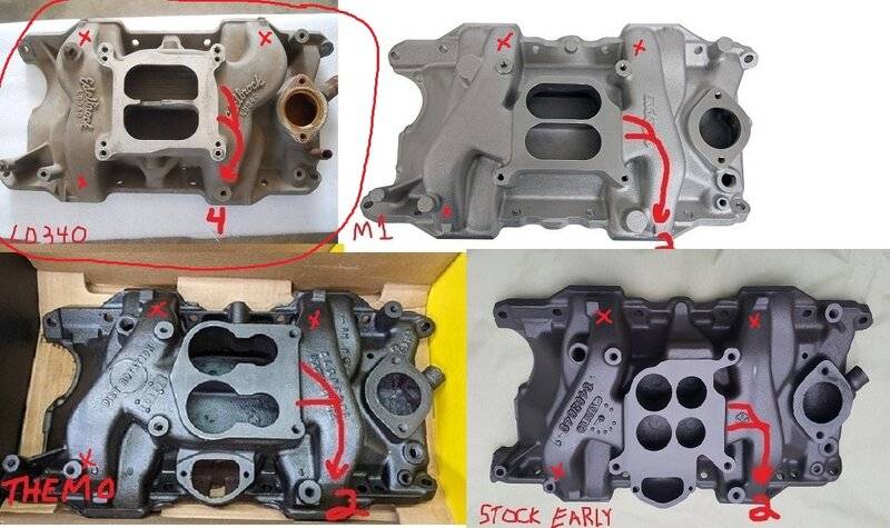

Ok so today I did a little research on small block intakes, the famed LD340 to be exact. What's so special about them and why they supposedly out perform all others?
This is what I found, look at the runner design, the LD340 runners are at the opposing ports. They hit on all the opposite cylinders as all the others. Could that have been Vic Edelbrocks secret with the LD340? The intake port pulses are better that way? Why don't the others all try this to see what happens? I checked other manifolds and all are different from the LD340.

They don't out perform all the others.
There's a bunch of old school hype about them.
The Edelbrock Air Gap outperforms it. And the Edelbrock RPM matches it.
But the LD340 will outperform those 3 other manifolds you have pictured. That's not saying much.
People get off on them because some have factory numbers. But that was just because Chrysler parts dept sold them over the counter. And the old DC Manual said to use them. But of course the Air Gap and RPM didn't exist then.

RPM 7176 looks very similar. Just ports arrangement is flipped top to bottom.
Both seem to have the same amount of stock resemblance to me.

The switching around of the runners from lower to upper plane could be due to a couple of reasons that I can think of; one is just packaging. If you look at other brand engines that have the same firing order, they vary in which cyls are upper & which are lower plane. Does it really matter? Somebody at Edel finally woke up [ maybe somebody went to Germany or Japan to see why they there making big HP #s ] that big runners are not as effective as smaller runners, hence the smaller CSA of the Perf intake. The new Perf might have been easier to package with the planes reversed.
The other possibility I can see for switching the planes. #7 fires after #5 cyl, so # 7 can get robbed of incoming charge. Short on air. Moving #7 to the lower plenum which has greater volume, might help with providing more air to #7.
This is a CID needing it or not. On a dual plane, I agree. We have seen this before a few times. The newer intake has a better runner and does t need to be large in size. This is why I think it works so well on the street. The air and fuel have an easier time moving into the head and cylinder. Less turning corners closer to a line of sight.

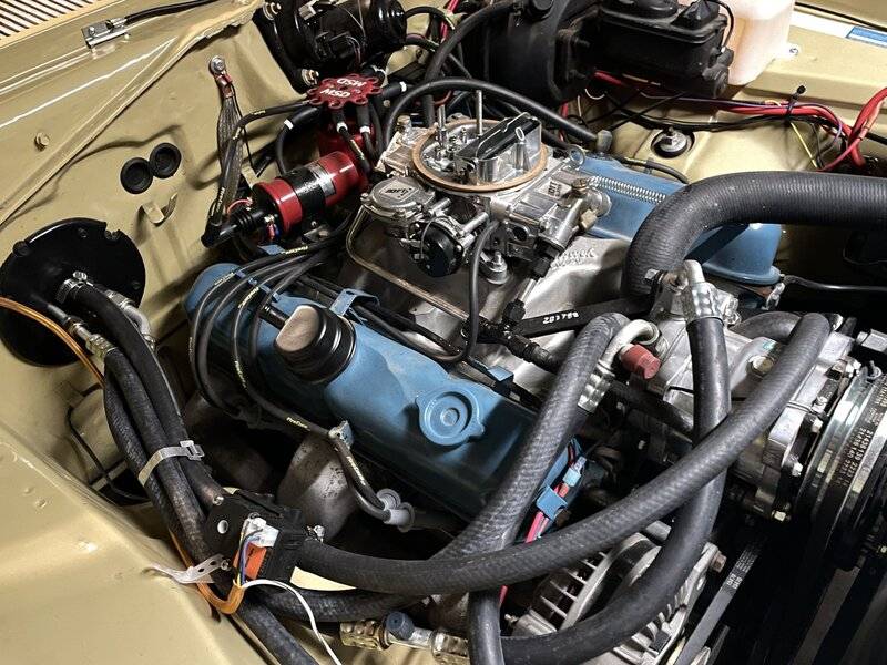

A. Edelbrock RPM-AG with a Mancini drop base air cleaner on my ‘67 Cúda.
