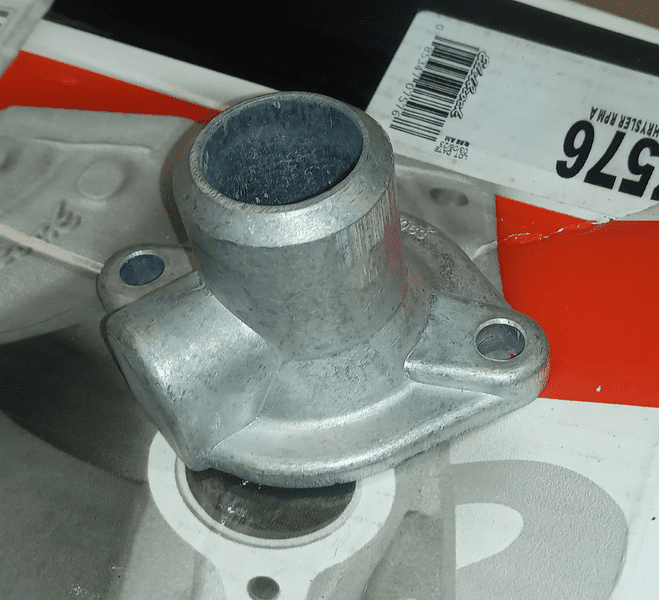

Just my 2c, op influenced me to go check my recently purchased t stat housing and t stat. Rock Auto for both, 5 bucks for housing. Perfect

Somebody, somewhere, would probably put that new thermostat housing in a lathe and just cut the opening bigger till the thermostat fit, or till they ruined it.
Let me save you (OP) some aggravation. Take that housing and throw it off a bridge now and find a factory piece. I’ve tried two of those and they both warped after about 6 months worth of heat cycles. I’d take them off and mill them flat again only to have them warp again. No amount of RTV will fix it. Bad metallurgy.
Junk. It will warp after a few years.
I bought the Dorman.
Do you know the specs for the thermostat OD? Maybe the stat is the culprit?
IDK, It's a stock replacement stat from carquest and it fits fine with plenty of room in the old housing. I shaved a little off the edge with the grinder and it fits like a glove now. I might shave the housing/neck recess a liitle bit too just incase for future repairs.

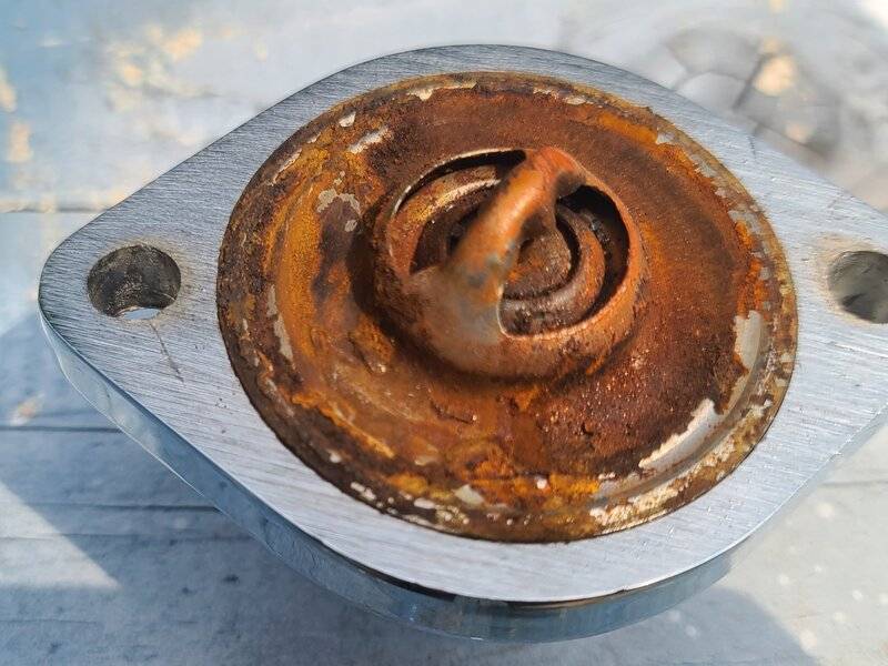

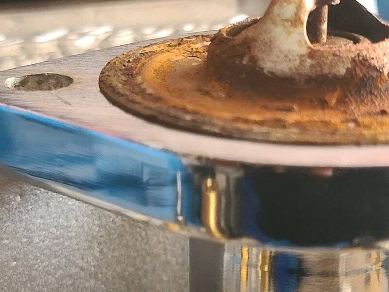

This should answer any questions about the thermostat being wrong. I put the old stat on it and it still does not fit. Also, yes the stat is upside down.
OP I think you are cruizin for a bruizin here on this. I think you should grit your teeth and heave that thing.
