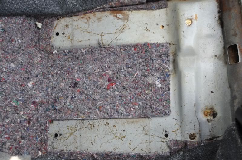

Mr Abodyjoe looking at your pic i guess the stock bench seat outboard mounts are plugged with a rubber plug, and the dimples off those outboard seat brackets that i assumed were alignment holes are actually for the outboard bucket seat tracks.
well that gets me closer and the pic you sent is worth 1,000 words. can you give me some dimensions in inches so i can go from there.
i can make the inboard reinforcement square plates myself, but can you give me a dimension L x W on these along with a thickness. i have some 1/16" plate that would probably do for this.
look at the pix in my photo gallery to see what i am talking about
