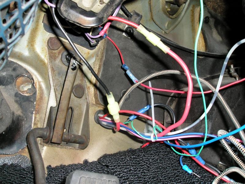

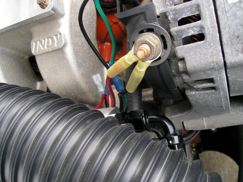

I have a few mods on my car to deal with the new alternator. I love having actual output at low rpm, so my lights don't flicker near as bad or dim like they used to. I wanted to bypass the ammeter because of the potential current issue (not to mention it was fraying at the firewall connection very badly to start with), but the whole dash and interior pretty much runs off of the back of it, so bypassing it wasn't the easiest way to go. Instead I just ran a second parallel wire from the alternator to the battery as an additional charge line. This way I have one line that goes from the alternator to the ammeter and one line that goes from the alternator straight to the battery. The ammeter doesn't really do anything now, but I still have full power in the interior, so I'm not really complaining since I installed an aftermarket volt meter in a little three gauge pod under the dash anyway.

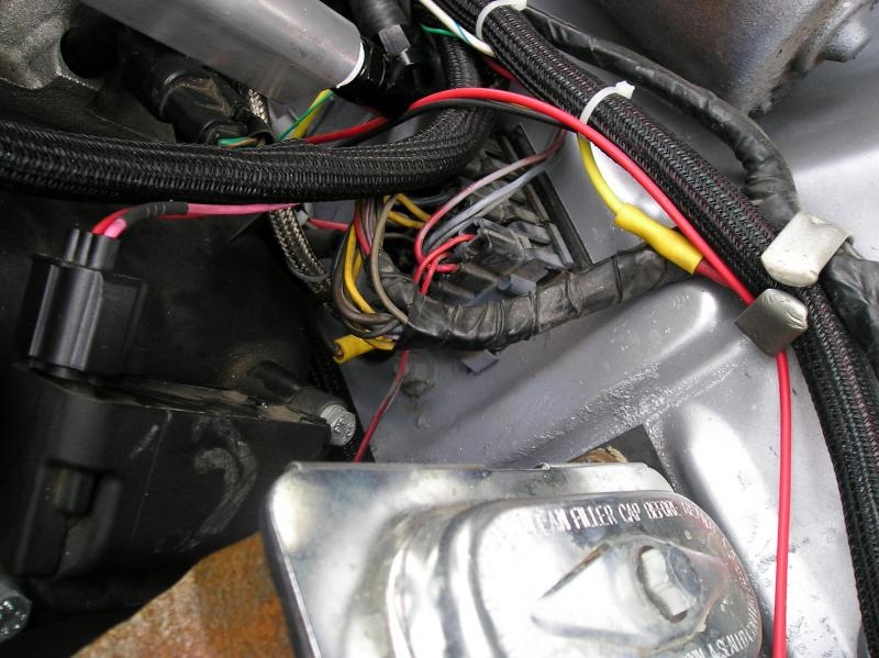

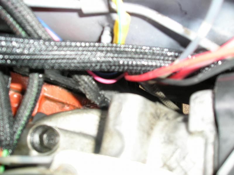

I guess I should have also mentioned that I redid the wiring through the bulkhead on my ammeter connection. I just drilled a new hole in the firewall and installed a grommet with some heavy gauge wiring. I used bigger more solid connections than the bulkhead spade connectors.
I can try to snap some tomorrow. All I really did was cut the wire at the bulkhead connector on both sides of the firewall and crimp some new heavy gauge wire to extend it through my new firewall hole. I didn't do any gauge rewiring like others have mentioned.
Here are some shots of what I did. The two big wires with the yellow connectors go up behind the dash to the ammeter (stock wires, just cut off at the bulkhead). They come out right behind the head on my car (pretty tight back there), and wire up to the stock wiring on the engine side of the bulkhead (yellow butt connectors). I also took a pic of the extra alternator charge cable I wired. It just runs back to the firewall along with the stock wire and then over to the starter relay box where the stock charge wire connected.
