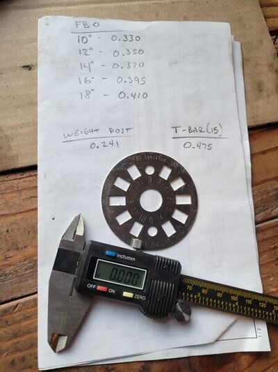

FBO plate over advancing
The measurement I used was how far the pins would travel in the slot……… not the length of the slot itself
Yup, that sounds more like the right concept. Thank you. Looks relatively close here.
one more observation:
Halifax got me thinking, my tbar is a 15, so 30* at the crank. I wanted 16* at the crank, so roughly half the slot. The picture below has the 16* slots under the tbar. The inside of both pieces are flush, the fbo plate should restrict the travel by more than it does.
my micrometer needs a new battery, so I wasn't able to get slot readings last night

I don't have an FBO plate, but you could measure the slots to make sure it's the correct slot. I know they are marked but it's something else to eliminate.

can someone verify these numbers are correct? Either my old caliper is off, the fbo plate or the chart.

Dont worry about the numbers on the plate, you already know it is misleading. Use that initial setting of 16* you placed it at and work your way back on the plate until you get the actual 16* you need. I have never used the FBO plate, But I did 3D print my own version using the same chart posted in this thread, and it is very accurate. This issue is the very reason I started measuring as described in post#34, that method lets you know exactly how much advance you are getting.
This is exactly what I decided last night. Found what advance slot the engine likes. This weekend, I'm going to weld and file the the Tbar to match and toss the plate in the glove box. Probably not necessary, but it will ease my mind.
Misleading. You're being too nice. They are flat out WRONG. When you pay 45 bucks for a thin piece of metal, it ought to at least be RIGHT.
