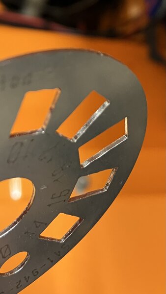

I set mine at the 14 degree mark and got 15 degrees of advance. Initial at 20 degrees, total went to 35. That is close enough and it worked out quite well. Yeah, I could have welded up the slots but this was far easier to tailor the total timing in less time with less work.

I wish they worked, too. I've tried them in five different applications now. Three for me and two for other people and the results were all the same. Incorrect advance amount from what was marked on the wheel.
While inconvenient, I don't see that as a total fail. It's already been stated that the slot length doesn't corollate to a specific number of degrees advanced for all distributors. There is variation. Once you see what one slot gives, it shouldn't take too long to figure out what you need to set it too to get what you need. I see it as a convenient method to test different timing combinations before pulling out the welder and files. Mine was off a couple degrees on the first try but I took that into account and nailed it on the second try. I'll use it to setup my new build before I commit to modifying the rotor.

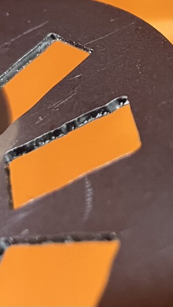

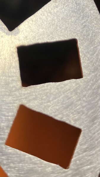

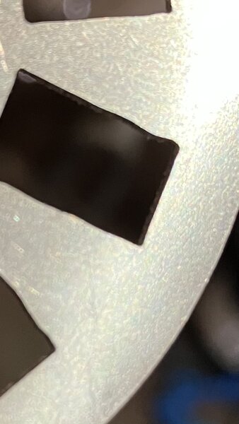

So after reading all of this I went ahead and bought one anyway. But with the OP issue in mind looked closely and noticed that the inside edges of the slots are not very smooth. I used a small file and worked the edges (especially the right side, thanks Mattax) to ensure the pins slide freely throughout the range of motion. I can't say it is/was TrailBeast's issue but it might at least contribute to an erratic advance curve. Let me see if I can post some pictures with enough detail before I filed it...

Some people love to bash the quality of a vendor's products. If you don't like the rough edges of the slots, take a file and dress the edges and make it nicer. Yeah, it would be nice if they were smoother but until they are, your options are to tune it up yourself of be a wimp and ***** about it.
Welding slots is cheaper but harder to "tune" and takes longer.
With how bitchy some people are, it is NO wonder that some people don't make the effort to manufacture products for our cars.
Crank degrees on that plate. The slot lengths for welding up a factory distributor are distributor degrees. I weld the inside edge.
That's some rough edges for a cnc cut piece. Dressing it is an option. As long as the pin doesn't hang up it the slot, meh...
