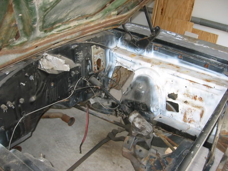

There is another current post about fenderwell/shock tower bracing. Seems like the concensus is that you need both. You have neither. Are you getting any flex where frame rail meets body? I just did a MII install and removed the factory inner fender panels and replaced with straight sheet metal. Thanks.
With an MII, you have to get rid of the shock towers, etc.
The reason you would keep the panels and or some kind of brace is to avoid any flex between the body and the framerails that could lead to catastophic failure.
