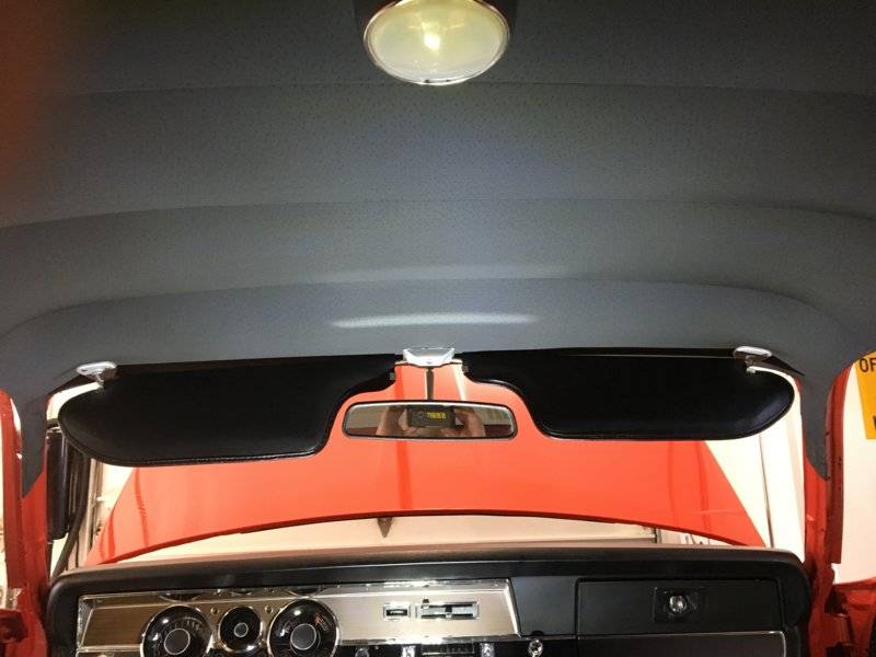

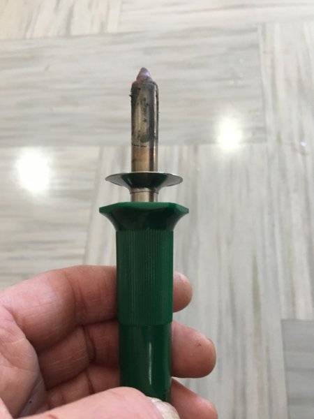

I finished installing the headliner today. There are a couple wrinkles in the sail panel area but I'm very happy with the finished job. I put all screws in for interior pieces such as dome light, mirror, visors, and seat belt harnesses before I installed the headliner. It made it easier to feel their location afterwards. I had an old wood burning tool that I ground to a point on my bench grinder. It was easy to just melt holes directly over the screws. It worked well and the liner won't tear.
Thanks Danny. I have to say that the headliner install went smoother than I had anticipated. I did it over the course of 2 days. i wouldn't hesitate to install another one if the chance arises in the future. It is a time consuming task and I can understand why a pro would charge $450. It's very satisfying to look at it and say "I did that." Another new skill to check off the list.
The headliner turned out really nice Kevin!
Fantastic job on that headliner! It took a professional upholsterer two days to do mine. It is not an easy job.

That makes me feel pretty good 340wedge. I figured that since I did the upholstery I might as well give the headliner a shot. Also, the upholstery shops wanted me to bring the car to them which would have been a big hassle.
I HATE leaving any car, customer or my personal hot rods, ANYWHERE except of course the (HDK) fab shop or my good friends body shop. IMO....I make enough mistakes without the careless help of others.
I love the "I can do it" attitude combined with the better than the "pros" execution
Everything looks fantastic. The Headliner, Front end, Drive Shaft. Super nice
