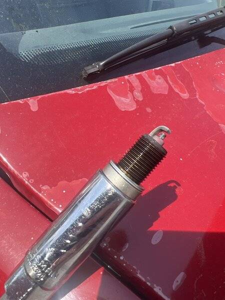

This is also one of my plugs. This is from low speed driving, some coasting, but not into the main jets, on the transition/idle circuit (what we’re currently working on).
36 at 3000 is probably too much. You need more initial and you need to slow the curve down. Leave the VA OFF until you get the curve sorted out.
I don’t remember your combination but I doubt you are making peak torque at 2500. As it is you’ve got 26 at 1500. That’s a TON.
Again, more initial, slow the curve down. You may have to modify the weights and get the heaviest springs you can find to control the curve.
If you are shifting at 5500 you’re probably making peak torque at 3800. That means you need to figure out how to get the timing at 3500-3800 about 24-26 degrees. Hen make the curve gain 1.5-2.0 degrees per 1000 rpm after that.
It matters where peak torque occurs. A wheel dyno is your friend. Better yet an engine dyno where you can load the engine but I suspect it’s too late for that.
