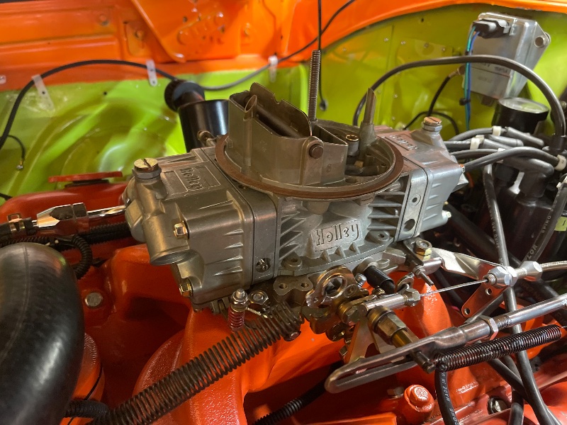

Calling 340 with Holley 650 dp

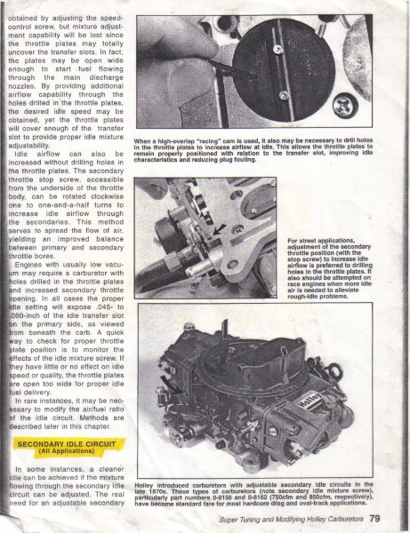

Not sure if it'll show up or if it'll be readable, but here's and article about 4-corner idle conversions.

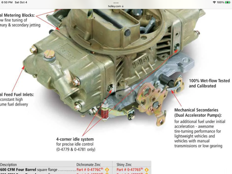

The 4777 I had on my 340 was an older version that already had 4-corner idle. I'm pretty sure the older ones came like that. Pretty straight forward to convert though.
AFAIK 4777’s, at least the zinc ones, never had 4 corner idle…….and probably still don’t.
In that series of carbs, none had it early on, and at some point in the 90’s the 750’s(4779) and 850’s(4781) got it.

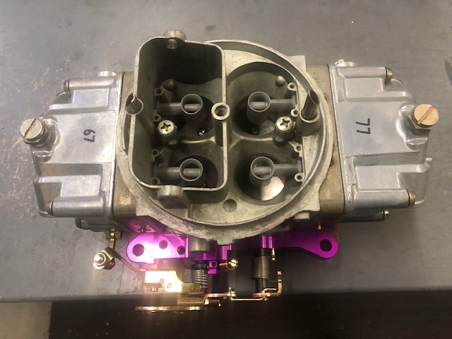

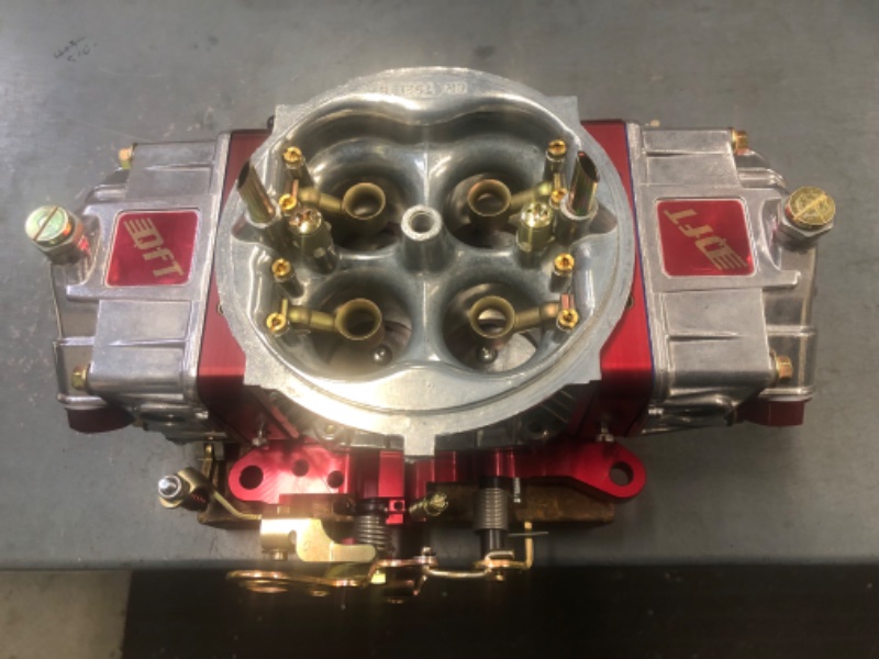

Quick question while I have you guys here. I have a brand new pro-form 750 sitting in a box. It’s a really nice carb. Questions is it too much carb for my 340? Would I be wasting my time trying it?
What primary and secondary jet sizes are you guys running assuming non stroked 340 motors with a Holley 650dp.
I am starting my tuning in earnest and I am currently running the stock 67 primaries and 73 secondaries. I believe I need to move up and am curious as to what you guys are running.
I know I know all our engines are different and that matters I know. BUT I am alone tuning without much history, friends etc to bounce questions or ideas off of. I want to gather jets that I can play with so just looking to see what you guys are using to look at the range of jets being used.

Just saw you posted that you have a "750" Pro-form. That is not too big if this is good flowing, high revving set up.
The 650 Holley may be slightly easier to get good idle and off idle.
Map out the Proform and then make its initial calibration more like an old school Holley 4779. Low idle jet, 2 open e-holes, etc.

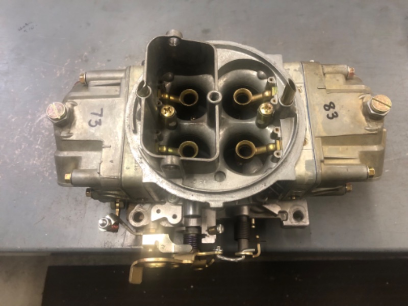

I also have a 4779 dyno mule, that was built from a left over main body that came from another carb that got the Proform main body conversion.
This carb actually got built mostly from new parts(back before all this stuff was crazy $$$).
New stock Holley baseplate and metering blocks, etc.
I had originally intended to do a main body swap on the dyno with it, using the Holley HP main body kit, but in the end I just ended up buying a bunch of QF parts and building another carb out of the Holley HP body.
Of course, about when I did that the Brawler carbs came out and you could buy one of those for about what I had in parts to put mine together.
Carbs have gone up enough in price now to where I’m not “upside down” with mine anymore.
