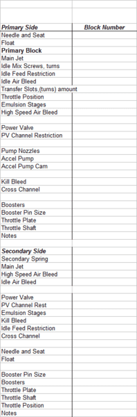

Make spread sheet or in a word processor listing all of the variables as found.
I also include the variables that get adjusted such as turns out on the mix screws, and idle stop.
So one sheet or one column on the spreadsheet is the factory setup or whatever baseline you want.
Then note every change and have a method to evaluate its effect.
Such as idle speed, how well it handled slipping into first, any issues when slowly opening throttles (by hand) in neutral. If there are issues or its astep backward, then make another change. If it seems OK, try a low speed test drive.
Focus on steady state conditions because they are the baseline.
here's the approach I suggest for tuning any non-stock build
Tuning for Performance.
Here's a blank example of the spreadsheet I use. Not all of it is important but its good to a complete list. Sometimes its handy to know what otherwise seemed unimportant like the numbers on a metering block.
Then note every and have a method to evaluate its effect.
See what I mean? This is an excellent post, not to discredit any of the other posts you made with excellent information in them, as there are more than a few. By not posting here you are doing this board a disservice. Thank you @Mattax for your contribution.
