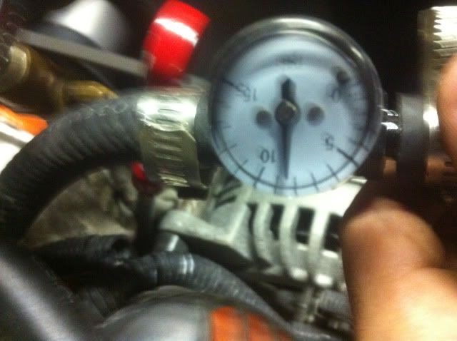

Well I picked up a cheapo inline pressure gauge. Hooked it up. Fired the engine up and checked it. It stayed about right here 8.5 to 9 psi with the engine cold idling and hot idling. And around the same when throttled... Might have dropped down to around 8 or so when throttled.
So what do you guys think?. You think that's what the problem is?. The summit carb manual suggests 5psi and no more than 7 psi.
I did cob up a brass pipe valve and used it as a make shift regulator . And dialed it down to 5 psi. It was still running rich but might of been due to the plugs being a little fouled now for all I know?.

If that gauge is accurate you have way too much fuel pressure.
Way too much pressure. Should be set to about 6psi.
