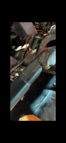

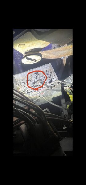

Blinkers. Red orange and lt grn. Orange for sure in the middle. I think Lt Grn is low and away from the other two. From what fsm says. I think red is left green right. Wasn’t sure if anyone knew off hand. I also have a second 90* stud connector coming off the fusebox like the one the voltage limiter capacitor. I guess Ill have to find out what that is doing. There is a butt connector mid wire, so I don’t know if it’s original. Could be a ground,
Car has battery disco, I pulled the cluster to fix pins and one of the bezels was loose. I put shrink tube on the bare connectors for the time being to avoid contact.
DO NOT ASSUME ANYTHING.
Most oem wiring will look like the other connectors so if it looks out of place it probably is not OEM
post a photo

Welp, I guess I’m a Dodo. I looked at these several times. Couldn’t figure it out. Got my lazy *** out to the garage, 3rd fuse in line, ACC, funky stud connector… I’m looking at the cigar lighter power. Thanks everyone for the help
