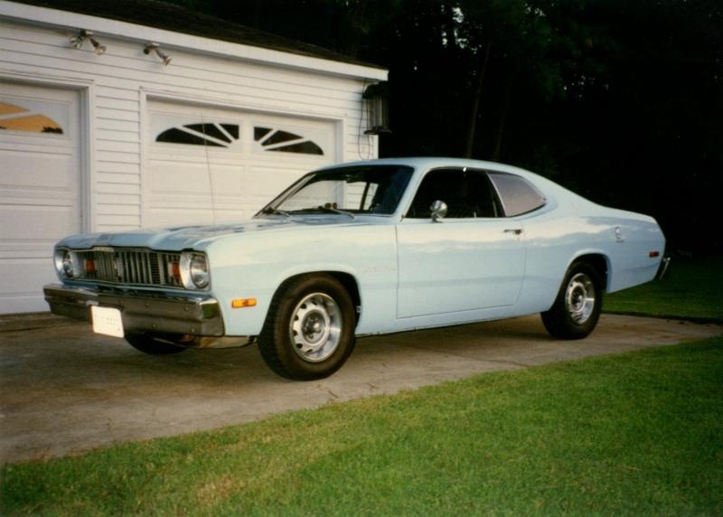

Post some pictures of yours, here was mine:
