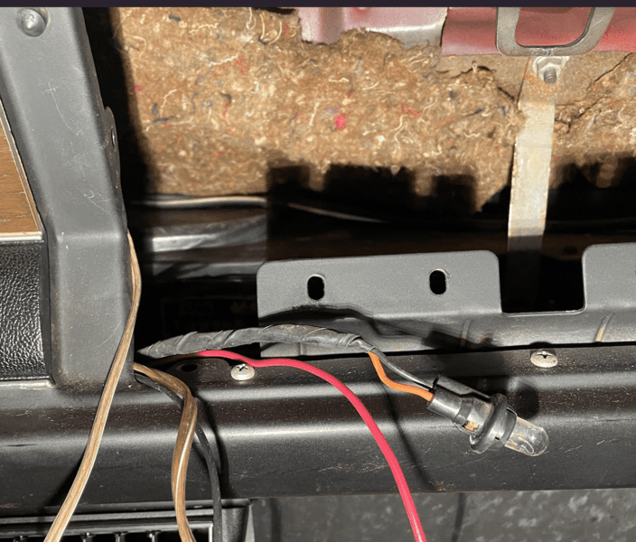

Guesses on this light?
jpstewart19
Jan 19, 2022
66
40
Chapel Hill, NC
Anyone have any idea where this bulb goes on a 73 Dart? Getting ready to put in the new glovebox insert in and found this light bulb along the lower left corner. Map light and glovebox are accounted for and the ashtray I believe is a single wire/metal connector.
Wiring diagram in FSM from Mymopar, find the orange & black wires that are under the dash on the passenger side.
Orange is normally associated with "dash dimmer controlled."
Only thing I can thing of is shift quadrant lamp I don't know what that looks like in 73
Or ash tray, the diagram shows that as being "dimmer controlled"
So is AC/ heater bezel lamp but that is too far away?
Back lighted climate controller has a lamp socket like, that mounted in white plastic.
My first ‘71 duster had a lighting convenience package that had a light like that mounted above the ashtray.
Found it this AM...it was the light for the climate control unit. Feeling around awkwardly back there, there is a hole for it toward the passenger side. Thanks for everyone's input.
