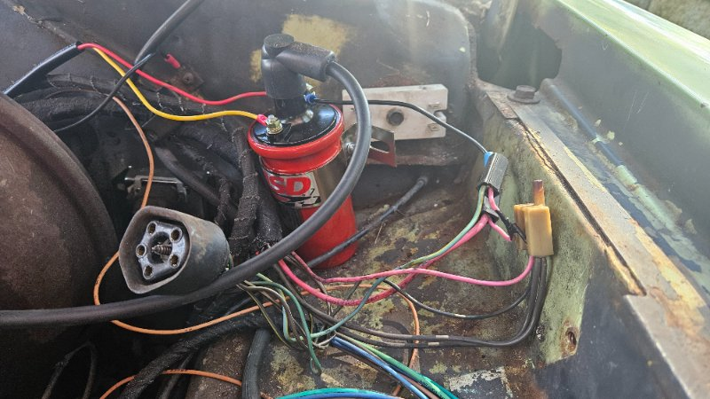

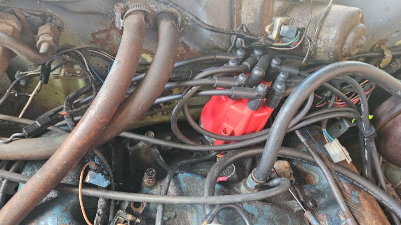

Thanks guys for the response. I'm attaching some pics to see if any help can be put to visual aids with my mess of an electrical system
Visual aids;)

DID YOU DO the voltage tests I told you about? THAT WILL tell the story. Looking at photos from hundreds or thousands of miles away will tell us not much. "I am guessing" from the photo here that the problem is EXACTLY as I have outlined.
GET A METER and GET A 12V test light and then we can go to town on this

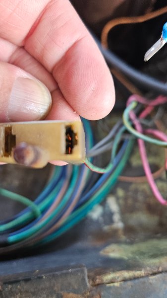

I am guessing that the black wire you have plugged into the old ballast connector is your "new power wire?" THAT CONNECTION GOES DEAD when you twist the key to start.
See the other two ballast connectors, the whitish ones? Put a test light in one, crank with the key, see if it lights. If not move to the second one. One of them should show power when cranking the engine. JUMPER that one to the black that you have plugged in.

I did the test light and the double brown wire lit up red the other one did nothing. I plugged the jumper wire in as it's seen in this picture. She starter up but then when I turned her off. Tried to start her again same thing turns over but stops. My buddy held the choke open she started again. Mind you the electric choke has been broken since the seventies my dad told only as of yesterday lol. I tried to start it again put a screw driver in the choke to keep it open still doing tje same thing won't stay started

This green and yellow wire is dead it goes to the 5 pin connector that went to the ecu box that is not hooked up anymore. Should I cut it?
I tried wiring from the brown to positive coil it's still not staying started. The engine fires but then shuts down. If I hold it just right it starts. But it should not do this
I can't tell what you have. Is this some aftermarket harness? What is all the wire that's coiled up?
