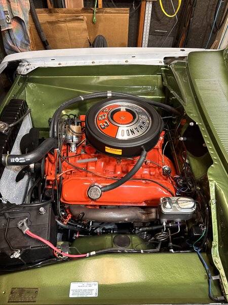

I thank fubo for all you folkses input , all the forums help so much . I think my car will be like no other so I really want nice clean headers , its a 50 k S 383 4 spd. Deluxe bucket int. Stroked to 550 hp so she needs to flow, if I cant buy em I will make my own but those dam bow tie guys have a ton of great looking and reasonably priced options that we mope dudes n dudettes dont have. Id rather find some done but Im supa shallow and looks are everything . Heres another shot f youll. love the input . Thanks
If you go with Schumacher Tri-y's, I modified mine to work with the four speed z bar, was a simple modification. Can send you pics if you desire. I really like them.
Please do post photos, that would b great, As for my vision of a good lookin header I dont want exit tubes to rise , Id rather see them all drop thats all , I have room.
I used a set of Hedman 78030 headers. Passenger side was pretty much a bolt in. The drivers side required substantial reworking. The rear or #7 tube had to cut off and brought straight down. #5 tube had to be cut and tucked in to clear the steering box. Also a little rework for starter clearance. I should also mention the # 7 tube I made removable so it could be slid in from the top. Application 1971 swinger 383-4 speed. Manual steer (o.e. Box). Manual disc brake mc. (Stock location). O.E. z-bar with modifications. I can say my set up would not play nice with your u-joint placement. I did use a u-joint in place of the stock coupler in the original location. Shortened the column collar also. Best of luck. With time and a ton of patience, you can come up with what will work best for you.Swingn’.
