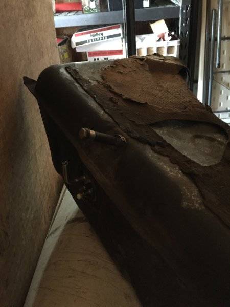

If it's an old tank I'd check in this water holding area too............

OK, to clear confusion. There is a spot on the tanks top where they hold water and rust through. Wouldn't be seen in the trunk. You said its a recent replacement tank so this probably isn't where your issue is.
