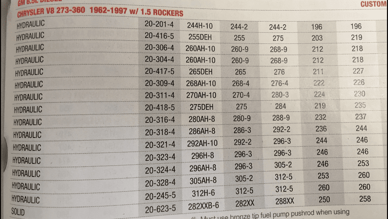

The SBM 265DEH hasn’t been discontinued, but it’s no longer in the regular SBM listings.
It’s in the back under the “Specialty camshafts” listings....... and it’s now a price code 5.
20-417-5

I was actually kinda wondering the same thing. The DEH description talks about utilization on engines with poor exhaust flow. In addition to a free flowing exhaust system on the car, LA heads have good exhaust ports and not so great intake ports right?
