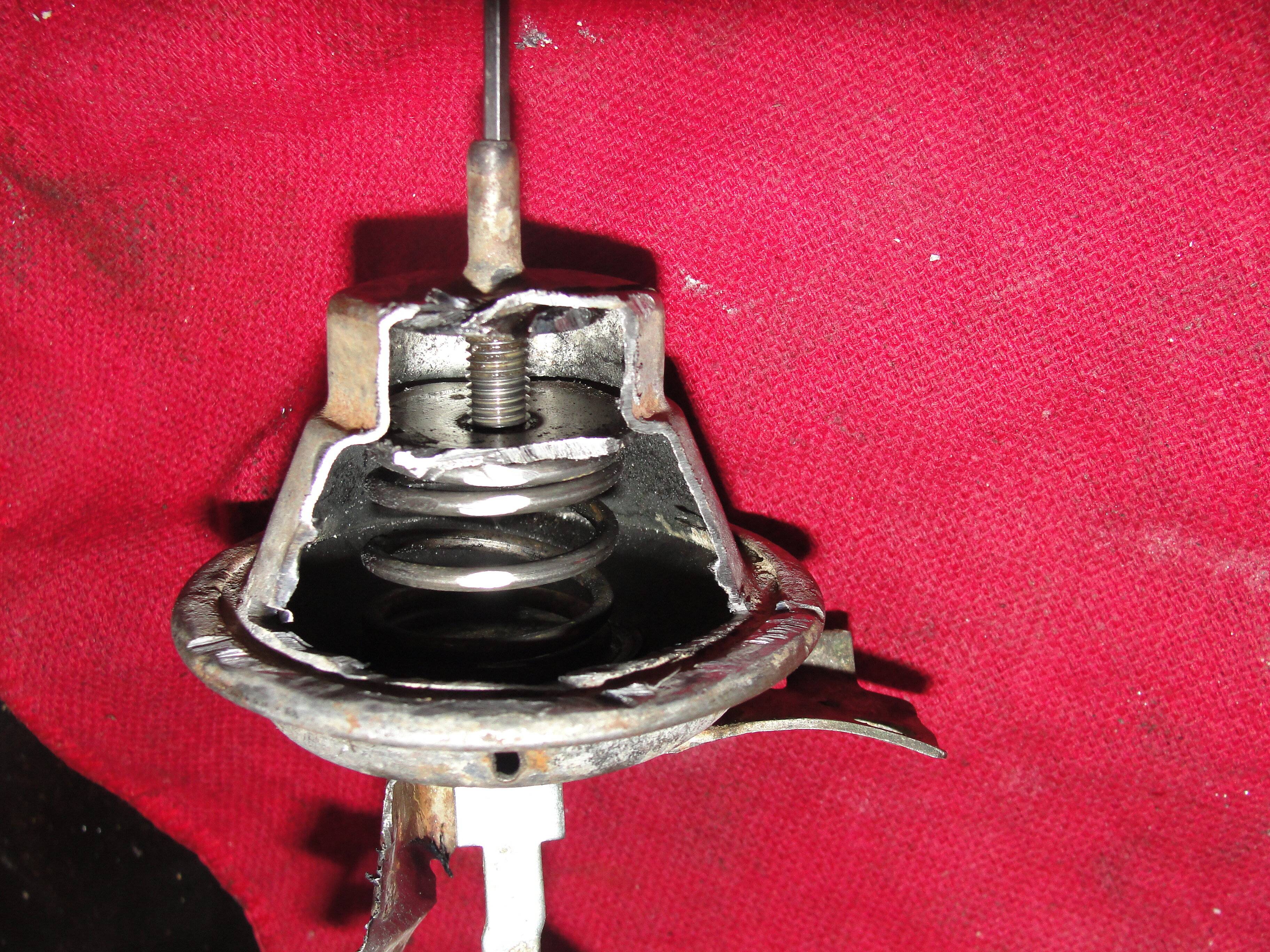

Turning the screw counter clockwise removes tension from the spring and allows the vacuum to more easily pull the advance mechanism. Conversely, turning the screw clockwise compresses the spring, making it more difficult and requiring more vacuum to operate the advance. I don't understand any of what you said, but that ^^^^ is how it works. ;)
Nope, turning the Allen Screw CW reduces spring tension, does not increase it. You ALWAYS start with AS would fully CW.

The distributor vacuum advance can doesn't 'pull' inches of Hg. It pulls a rod WITH the application of vacuum to the can. It does advance the spark depending on the amount of vacuum it is attached to and when that advance starts in the vacuum 'curve' (given amount of vacuum at particular RPM) is dependent on the setting of the allen-spring INside the vacuum canister.

If I may....
Rusty, you got it right from the standpoint of thinking righty-tighty/lefty-loosy and all, but it's NOT the 'bolt' of the contraption that is changing, it's the 'nut'. ...I think.
Of course, it COULD have been a LHT assembly...:eek:
Good pic!
If I may....
Good pic!
